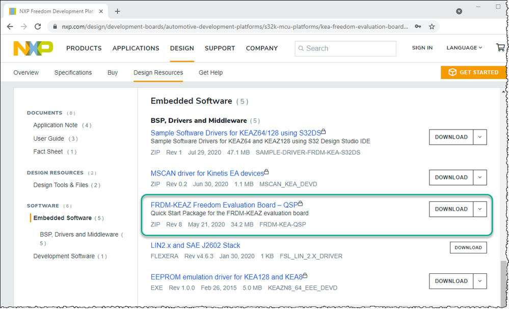

You can find examples in Quick Start Package for the FRDM-KEAZ evaluation board(FRDM-KEA-QSP). Please open these examples by using S32 Design Studio for Arm 2018.R1 – Windows/Linux
FRDM-KEA-QSP.pngFRDM-KEA-QSP.pngDriver Test SW for KEAZN32.pngDriver Test SW for KEAZN32.png
