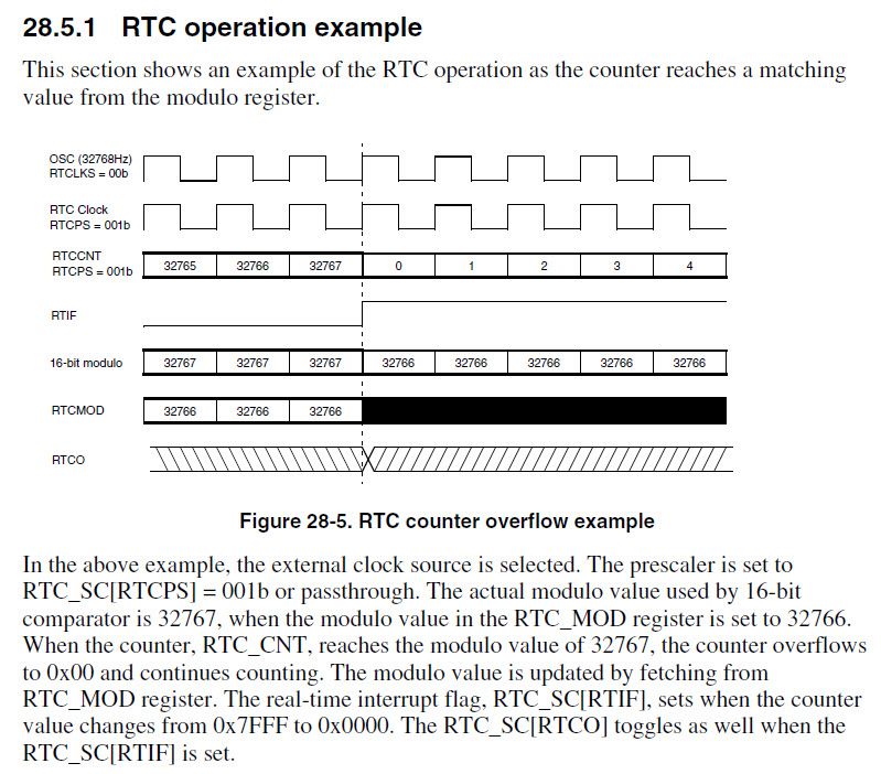

jeremyzhou
Hi Jacques,
According to the fig 1 illustrates , you'll learn that
                                                                          Fig 1

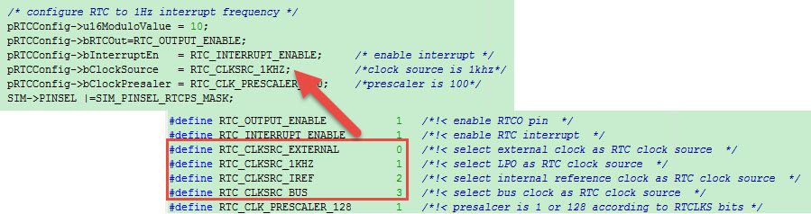

jacquesnapoleon
Hi Jeremy,
Thanks for your reply.
I already had this kind of project taken from library.
Seems that this output RTCO coming from 1kHz LPO.
I would like to configure RTC clock gated from ICS, then controlling ICSIRCLK gate and SIM RTC/WDOG gate (refer to top of Figure 5-1 clocking diagram from RM).
The output frequency should be 32kHz.
I already tried this but this does not work up to now...
Many thanks and best regards,
Jacques.

jacquesnapoleon
Hi Jeremy,
Thanks for your reply and you help on this topic.
I already tried this but it cannot make appearing 32kHz frequency to RTCO pin.
I only want to use 32kHz IRC as an external signal to drive external components...
I modified the initial code as shown below.
In that case, I observed ~19.73kHz on RTCO pin which it supposed to be the 39,0625kHz divided by 2 (?), as if PTC5 output FTM signal (ICSFFCLK/2) instead of ICSIRCLK... However, RTC0 pin is well assigned to PTC5 in SIM_PINSEL as RTCS = 1...
Thanks and best regards,
Have a nice day!
Jacques.
int main (void)
    uint8_t         u8Ch;
    ICS_ConfigType  sICSConfig;
    RTC_ConfigType  sRTCConfig;
    RTC_ConfigType  *pRTCConfig = &sRTCConfig;
    UART_ConfigType sConfig;
    ICS_Trim(ICS_TRIM_VALUE);
    LED0_Init();
    LED2_Init();
    /* configure RTC to 1Hz interrupt frequency */
    pRTCConfig->u16ModuloValue = 0;
    pRTCConfig->bRTCOut=RTC_OUTPUT_ENABLE;
    pRTCConfig->bInterruptEn   = RTC_INTERRUPT_ENABLE;     /* enable interrupt */
    pRTCConfig->bClockSource   = RTC_CLKSRC_IREF;          /*clock source is 1khz*/
    pRTCConfig->bClockPresaler = RTC_CLK_PRESCALER_128;    /*prescaler is 100*/
    SIM->PINSEL |=SIM_PINSEL_RTCPS_MASK;
    RTC_SetCallback(RTC_Task);
    RTC_Init(pRTCConfig);
    /* Enable IRCLK */
    ICS->C1 |= 0x02;
    /* switch clock mode from FEE to FEI */
    sICSConfig.u32ClkFreq = 32;     /* NOTE: use value 32 for 31.25KHz to 39.0625KHz of internal IRC */
    ICS_SwitchMode(FEE,FEI, &sICSConfig);
    while(1)
3,781 Views
jeremyzhou
Hi Jacques,
                                                                          Fig 1
Ping
3,780 Views
jacquesnapoleon
Hello Ping,
This could explain the frequency observed...
BTW, where this formula comes from, I did not find it in the reference manual...?
Jacques.
3,780 Views
jeremyzhou
Hi Jacques,
The formula is created by myself, by using this formula, I think it can help you to understand it easily.
Ping
