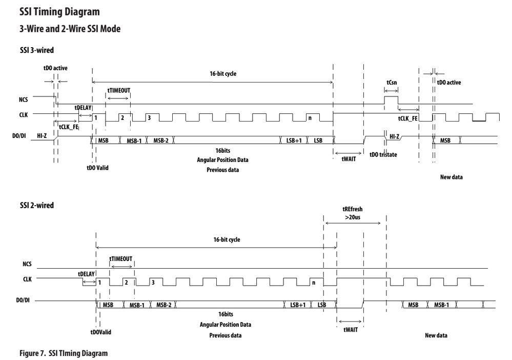

yes it is Synchronous Serial Interface. I was going through the PE component SSI_LDD incode warrior, there were too many pins to configure. The timing diagram which is required by the sensor is as follows

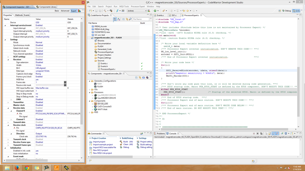

I was thinking of using 2 wire SSI mode so I configured the PE component and did the connection with CLK--->Receiver clock PTC9 and DO/DI---->Receive data channel 0 to PTC5. i.e
The sensor is supposed to give the readings automatically but I need to know if the pins assigned and the SSI_LDD settings done is correct or not as I am getting only "0" as received values.I am also attaching my program just have a look.

Kan_Li
Hi Amit Kumar,
I investigated the timing of the sensor, but found it can not meet the SSI spec that  K20 can support , because K20's SAI module doesn't support gated clock mode, the clk outputs continuously, so I would suggest you using DSPI module instead. and you have to set CONT_SCKE = 0(Continuous SCK disabled.), CPOL = 0(The inactive state value of SCK is low.) , FMSZ=0xF, and CPHA = 1(Data is changed on the leading edge of SCK and captured on the following edge.), Please also note to simulate the timing, you have to read the data out as the following pseudo-code:
//Set SCK as GPIO , output high before initialize DSPI module;
init_Dspi();
while(1){
//Set SCK as SCK function
//read SPI
//Set SCK as GPIO, output high
Hope that helps,
B.R
Kan
