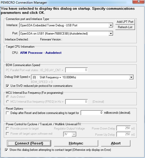

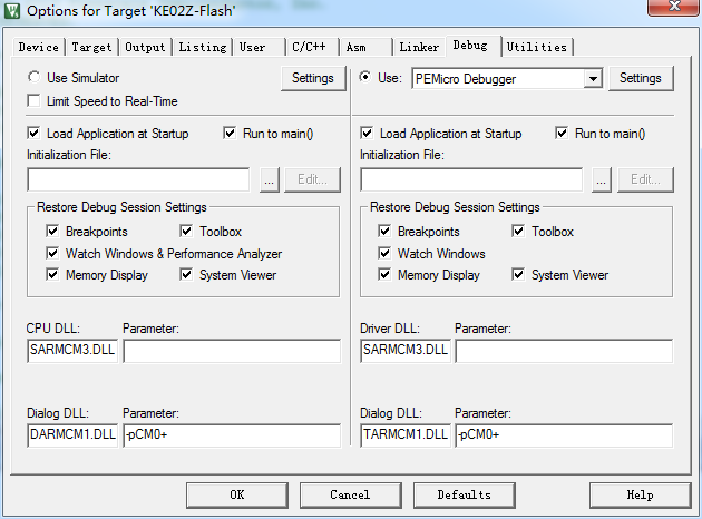

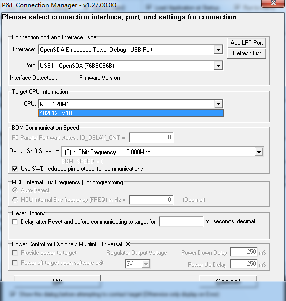

据说FRDM-KE02Z40M有板基仿真器,可以利用OPENSDA直接烧写程序,有没有人能告诉我烧程序的具体步骤。
下面附上一些图:(CPU选型中没有要的型号,怎么办?)
点击DOWN就出现下面的情况:
再点击connect就出现:
Now,i don't where the question happend .
Who can help me ?
Thank you !

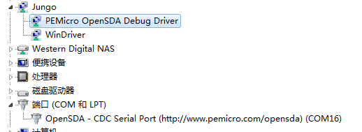

You may need to install "Freescale Kinetis OSJTAG Drivers V1.20".
Robin
3,251 Views
tongjunqiang
Hi Robin_Shen,
Thank you for your help !

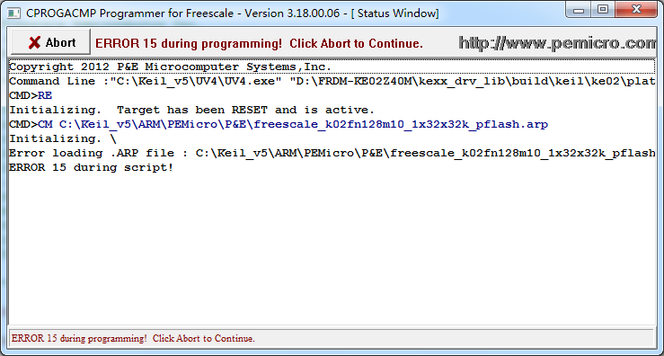

I have installed "Freescale Kinetis OSJTAG Drivers V1.20" , before meeting these questions.
Now , it show me the message. I can't understand.
Best wishes !

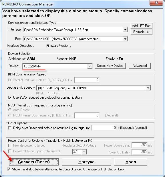

It seems that you have selected the correct CPU. (The MCU on FRDM-KE02Z40M board is MKE02Z64VQH4.)
Just click the "Connect" buttom to start debug.
