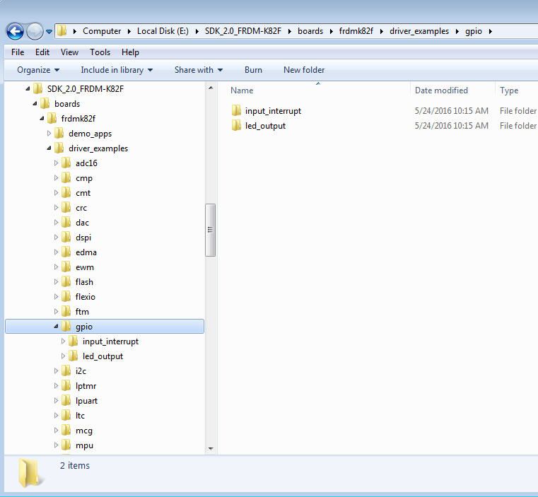

You can refer the gpio driver examples in SDK_2.0_FRDM-K82F. It can be download from Kinetis SDK Builder (REV 2 & 1.3).

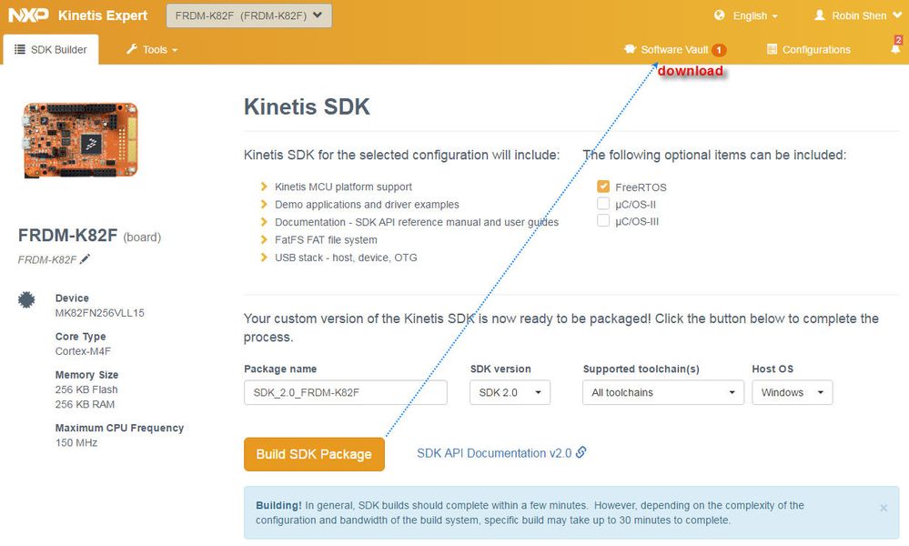

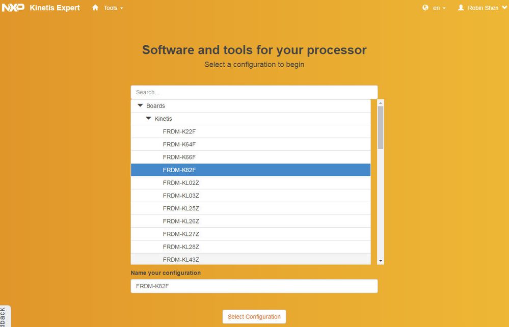

Please select the FRDM-K82F Configuration first, then build and download SDK_2.0_FRDM-K82F.

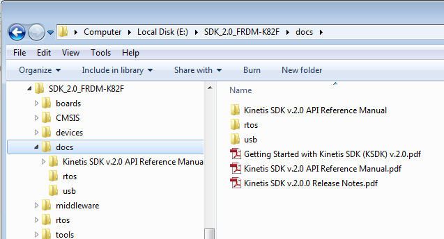

The Kinetis SDK v.2.0 API Reference Manual can be found in docs folder.

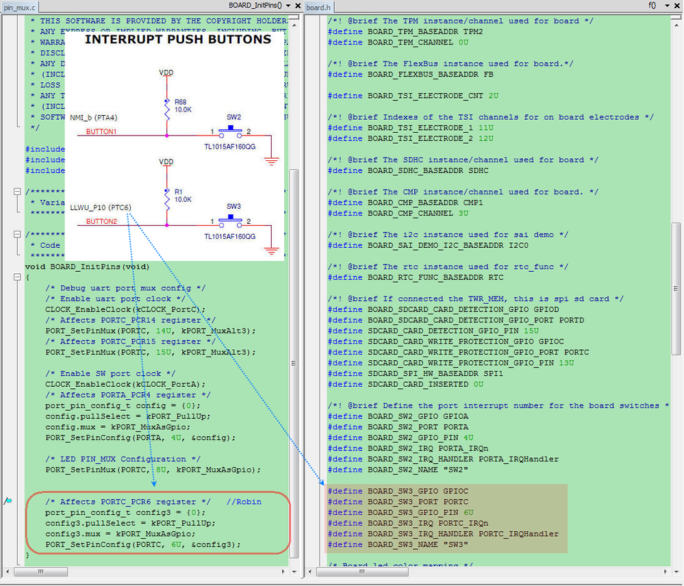

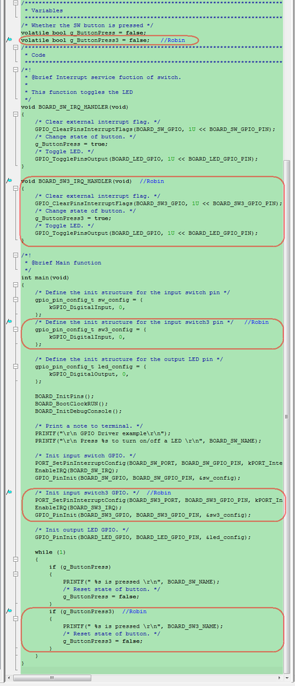

There is a variable g_ButtonPress, when ever we press Switch2 it changes i tried with new varible name g_ButtonPress3 so that we can detect press of switch3, but nothing happens,  in code also g_ButtonPress is once defined as bool and set to true and then later set to false , but how this is conncetd to switch2,  could ypu please tell me.
3,015 Views
Robin_Shen
Hi Sandeep,
The variable g_ButtonPress is conncetd to switch2 by BOARD_SW_IRQ_HANDLER().
You can refer the attached code to achieve using SW3 toggle LED_RED.
