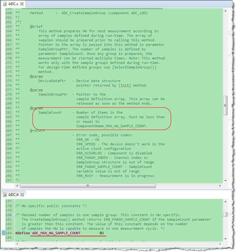

how many ADC sample can use in the MKE06Z128VLK4? I cannot read 9th(SampleGroup[8])ADC data (already used 8 ADC). Plaese help!

void Adc_init(void)
/* ADC initialization */
MyADCPtr = ADC_Init((LDD_TUserData *)NULL); /* Initialize the device */
Vr_temp_PutVal(1);
/* Create 8-sample group */
SampleGroup[0].ChannelIdx = 0U; /* ADC of Vref */
SampleGroup[1].ChannelIdx = 1U; /* ADC of T1 */
SampleGroup[2].ChannelIdx = 2U; /* ADC of T2 */
SampleGroup[3].ChannelIdx = 3U; /* ADC of T3 */
SampleGroup[4].ChannelIdx = 4U; /* ADC of T4 */
SampleGroup[5].ChannelIdx = 5U; /* ADC of T5 */
SampleGroup[6].ChannelIdx = 6U; /* ADC of T6 */
SampleGroup[7].ChannelIdx = 7U; /* ADC of VCP */
SampleGroup[8].ChannelIdx = 8U; /* ADC of current shunt */
PE_Error = ADC_CreateSampleGroup(MyADCPtr, (LDD_ADC_TSample *)SampleGroup, 8U); /* Set created sample group */
if(PE_Error != 0)
SS_ERROR=0x71;

Hi 育鈞,
Sorry for the late reply!
Number of items in the sample definition array. Must be less than or equal to ComponentName_MAX_HW_SAMPLE_COUNT.
Robin
