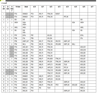

What does ALT0, ALT1, ALT2, means...? Thank you
462 Views
Celeste_Liu
The full name of ALT is "alternative", which means other options different from the default way.

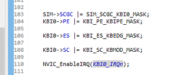

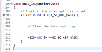

I choose the keyboard interrupt for the pta1 and the pta3. And then I updated the code.
Then I understand that I have to use some mask and activate the interruption.
But still the interruption is not being triggered.

For the first question, the answer is yes. I know that you are using the MKE04Z8. Specifically, you can refer to "10.2.1 Signal Multiplexing and Pin Assignments" in the Reference manual, as shown in the following figure.
