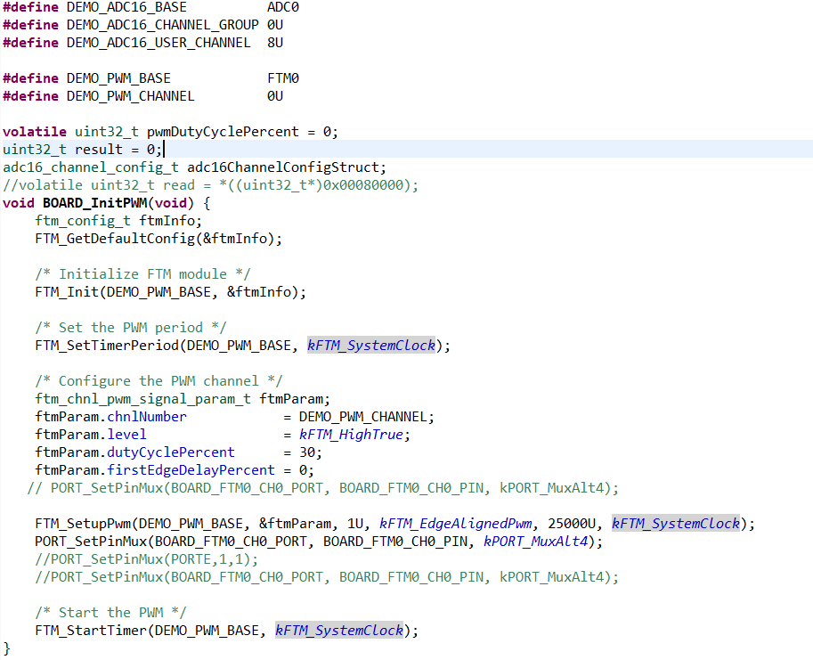

 In mkv31f12vll12 controller using ADC inject trigger method  configure when I configure  PWM pin program stuck in HARDFAULT HANDLER  any suggestion let me know
The below line is for configuring PWM pin
PORT_SetPinMux(BOARD_FTM0_CH0_PORT, BOARD_FTM0_CH0_PIN, kPORT_MuxAlt4);

Before you write the PORTx_PCRn reg, you have to enable the PORTx gated clock by setting the PORTx bit in SIM_SCGC5 reg.
Hope it can help you
