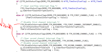

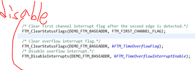

But the interrupts are all disabled. Where can I restart?
Because the captured value will not change.
But use the restart button:
8,666件の閲覧回数
nxf56274
Comment that code.

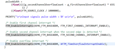

erichsu

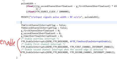

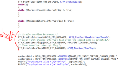

erichsu_0-1618887970058.pngerichsu_0-1618887970058.pngerichsu_1-1618888008064.pngerichsu_1-1618888008064.png
The interrupts are not disabled again in the while loop.
Where do I need to enable the interrupt again?
8,644件の閲覧回数
nxf56274
You can enable the channel interrupt in the while loop in main function.

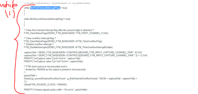

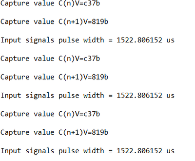

I have done this, but the interrupt program repeats the judgment.
Put the code here:
8,627件の閲覧回数

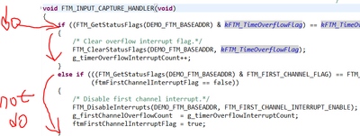

nxf56274
Due to this code edgeParam.mode = kFTM_OneShot, the capture will only run one time.
Change it to kFTM_Continuous.

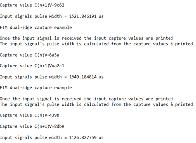

erichsu
erichsu_0-1619003698114.pngerichsu_0-1619003698114.pngerichsu_1-1619003741799.pngerichsu_1-1619003741799.png
result:
The rising and falling edge values are not captured?

nxf56274
Use a while loop.
