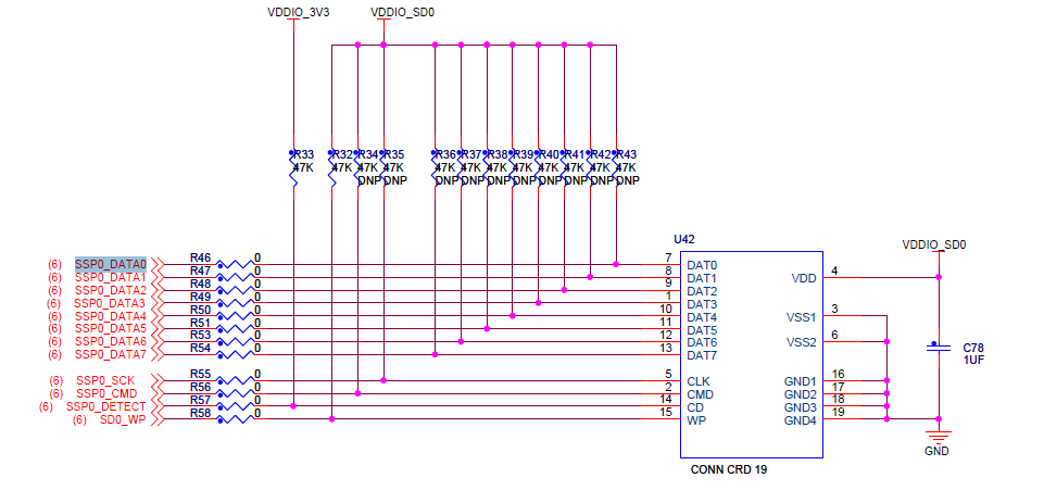

Is there any application note how to connect eMMC to KINETIS (K65)?
2,597 Views
Hui_Ma
Please check below eMMC interface schematics example. Thee are no dedicated lines for card detection [CD] and write protection [WP], which must be implemented using GPIOs, also; all the lines must have a 4.7K pull up resistor tied to a VDD=3.3V.
Wish it helps.
Ma Hui

goranigic
Hi Hui,
Just a quick question
the SSP0_Interface is available in K65?
Goran
2,597 Views
Hui_Ma
Hi Goran,
K65 doesn't have dedicated SSP interface (Synchronous Serial Port), while it provides SPI/I2C/I2S interface.
Wish it helps.
Ma Hui
