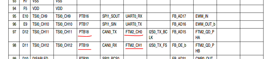

Since you are using the FTM combine mode, you will be able to use only the pins marked as FTMx_CHn for the selected modules and channels.
In the example I sent you, we are using FTM2 and the channels 0 and 1 for the combine mode, so you will be able to use only the pins that offer outputs for those channels. In this case those are PTB18 and PTB19 as shown in the PIN muxing table on chapter 10 of the Reference Manual.
So, if required, you can use any pin marked as FTMx_CHn by configuring the proper FTM module and channels for combine operation.
