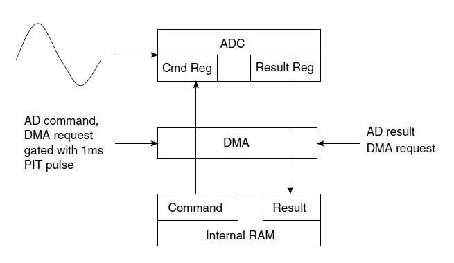

I use Kinetis K64, and I need to send command to ADC by DMA.
I found some app note and quick guide that explain how to do:

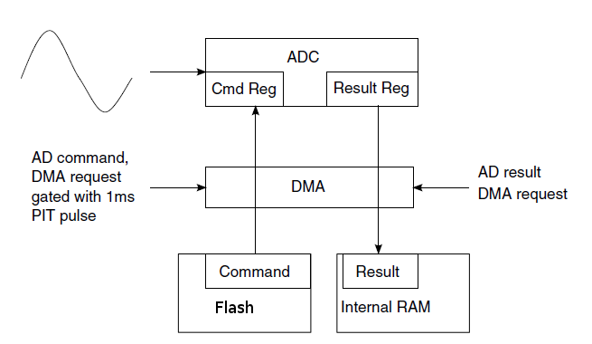

If the command buffer is in RAM, it seems that DMA can access it and correctly transfer those commands in ADCx_SC1A.
Instead, if that buffer is in flash (ie. const declaration) it doesn't works:
I cannot figure out why.
any suggestion?
best regards
Max

There may be another application note of interest here: http://www.utasker.com/docs/uTasker/uTaskerADC.pdf
Your DMA bus master should have authority to access Flash by default but check that you haven't taken it away by modifying FMC_PFAPR.

I tried modifing FMC_PFAPR in this way:
  FMC->PFAPR |= 0xFFFF;
without any cange in the behaviour
best regards
