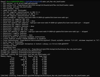

I am workking with FMU board for @HoverGames and while trying to Flash firmware on it using JLink I am getting a protection issue to write.
Apperantly I was able to Flash a bootloader, one I build myself as shown here
Here is the Flash process

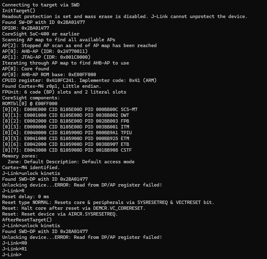

Afterwards any attempt to write to the device is failing and message after connecting shows
Readout protection is set and mass erase is disable. J-Link cannot protect the device.
Any advice how to debug this?
