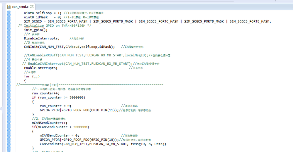

Everyone:
    I am learning the CAN module.This is my program.When it is debugged, the flag about sending data doesn't be equal to be 1,so it can't be sent successfully.

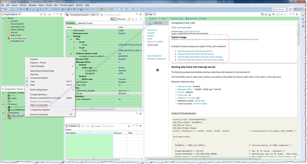

Robin_Shen
Hi Minmin Zhengzheng,
I recommend you refer to the "Typical Usage" of CAN_LDD in KDS3.2 ide , you can find them at here:
Hope it help! Have a nice day.
Robin

hello:
I am using the codewarrior10.7,there is the can demo in Processor Expert. Is it the same as what you have said about "Typical Usage" of CAN_LDD? But the demo doesn't include the K60F120M.
10,035 Views
Robin_Shen
Yes. You can use it.
The usage of CAN_LDD is the same. You can create a Processor Expert project and refer that example.

It's difficult for me to learn the Processor Expert. I am a beginner. The teacher told me to use the CAN module to transimit data immediately instead of learning others. So I program the CAN procedure by myself according to other demo in Codewarrior10.7.Can you help me figure out my program?

Robin_Shen
Please test the attached project.
And make sure you have connect another flexcan node on the CAN bus.
There are no CAN transceiver on TWR-K60F120M, you may need to connect it with MCU can_tx pins.
(It's sould be better test it with can bus analyser.)
