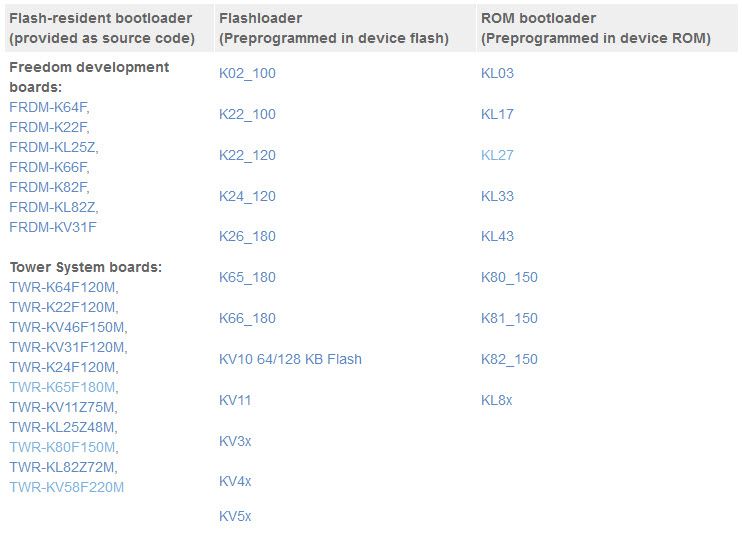

     I am a rookie for KDS developement. Now we used Kinetis KL03 chip and I follow document to type blhost command. some results are different from document. I am not sure whether is our problems or different ROM bootloader issues? The differences are below
D> blhost -p COM11 -- get-property 1
Current Version: 1.0.0
D> blhost -p COM11 -- get-property 12
Reserved Region: Flash: 0x0-0x0 (0 bytes)
D> blhost -p COM11 -- write-memory 0 "{{aa bb cc dd}}"
Wrote 4 of 4 bytes  ---- OK
D> blhost -p COM11 -- read-memory 0 4
Response staus = 10000(0x2710) KStatus_UnknownCommand
Response word 1 = 0(0x0)
Read 0 of 4 bytes

The ROM bootloader in the KL03 hasn't support the read-memory command until now just as the Fig 1 illustrates.
Hope it helps.
Ping

jeremyzhou
Hi Ken,
The KL03 also has the ROM bootloader, in another word, the kind of bootloader doesn't reside in the flash.
So the reserved region is 0x0~0x0.
Hope it helps.
