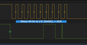

Hi, I'm working on a bare metal I2C multimaster library for the MKL25Z4 and I'm having issues when trying to enumerate attached devices to the bus.
The process I follow is basically: START --> Write[address] --> STOP. By checking the ACK bit I know if there is a device listening or not.
It works from time to time but on most occasions the bus stays lock with both SDL and SCL lines low:
The picture above shows a device attached "listening" on address 0x03. See how the ACK is issued by the servant device, but the master seems unable to STOP the transmission. This doesn't seem to happen when sending actual data (START -->WRITE[address] --> BYTE[1] --> BYTE[2] --> ... --> STOP).

Hello Alexander:
Do you still have this issue?
I checked your first code above, and I think it is not a good logic. Checking all status flags at once is not correct, since each flag has a different meaning. Also re-configuring the slave for each read is not always required. Then you used the recommended flow diagram of the Manual and although it is for interrupt mode it can also work by polling IICIF, but not if polling all flags at once. Typically as shown in the diagram you just poll IICIF (or enable interrupts) and then take action based on the flags set.
More specifically about the issue, when the KL25 I2C in slave mode receives a byte, it holds the SCL line low (clock stretching) until the I2C Data Register is read. This must be happening in your case, somehow your flag checks are overlapping and you are missing a read from the register, that is why it works reading the register in a loop.
I hope this helps. Let us know if any progress.

alex323qp
Hi Jorge, thanks for your reply, and apologies to you and mjbcswitzerland​ for the delay in my response; I was on christmas holidays.
You are correct, the original code was poorly written, the updated version (second post) implemented the flow diagram from the datasheet.
The problem was basically what you indicated; the slave was holding the line low because the program was busy with another subroutine. The interesting part was that even after reading the data from the register (which I was expecting would release the line), the line remained low, it looks like the devices went out of sync or something. The solution was basically making sure the slave device was always available to read the register when a new byte arrived.
Though Mark's response helped me greatly to solve the issue, I'm marking yours as correct since clock stretching was the specific cause of my problem.
Thank you all for your help and happy (belated) new year :-)
