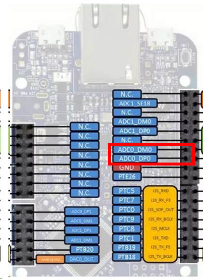

I'm using frdm-k64 board.i want to read adc input from ADC0_DM0/ADC1_DM3 pin.
is there any example code for the diffential mode analog reading?

Unfortunately, there is no driver example for the K64 with ADC differential mode. However, you could use the SDK driver example called "adc16_interrupt" and modify it so it can have the differential mode; for that you just have to change the ADC0 channel to the one corresponding to the ADC0_DM0 & ADC0_DP0 (Channel 0):
#define DEMO_ADC16_USER_CHANNEL 0U /* ADC0_DM0 / DP0 */‍‍‍‍
Also, as Mark just said in his answer, you also have to set the ADC_SC1A_DIFF; for that, in the same driver example just set to true the "enableDifferentialConversion" from the channel configuration:
#if defined(FSL_FEATURE_ADC16_HAS_DIFF_MODE) && FSL_FEATURE_ADC16_HAS_DIFF_MODE
    adc16ChannelConfigStruct.enableDifferentialConversion = true;
#endif /* FSL_FEATURE_ADC16_HAS_DIFF_MODE */‍‍‍‍‍‍‍‍‍‍‍‍
In order to check if this works, check the ADC0_DM0 and ADC0_DP0 from the FRDM-K64:
I hope this information can help you.

For differential mode you just need to set ADC_SC1A_DIFF in addition to the channel reference in ADCx_SC1A.
However differential input between ADC0_DM0 and ADC1_DM3 pin is not possible - it can only be between
or
ADC1_DM3/ADC1_DP3
etc.
