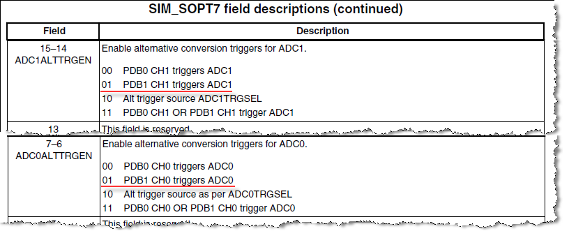

Hi all,
 Anyone can handle PDB1 (not PDB0) on KV10&KV11 series? It seems this can not tied to FTMx to acquire ADC conversation. The target application is consist of two ADC conversations on PWM on high&low levels regarding to delay val of PDB (centeret alligement is not helps)
 PDB0 can handle the job listed above but PDB1 is not. A simple init rouitne will be sufficent.

You can test the ftm_pdb_adc16 demo. (C:\SDK_2.3.0_TWR-KV11Z75M\boards\twrkv11z75m\demo_apps\ftm_pdb_adc16)
Additional configuration needs to be written when PDB1 module is used:
    SIM->SOPT7 |=SIM_SOPT7_ADC0ALTTRGEN(0x01)|SIM_SOPT7_ADC1ALTTRGEN(0x01);
