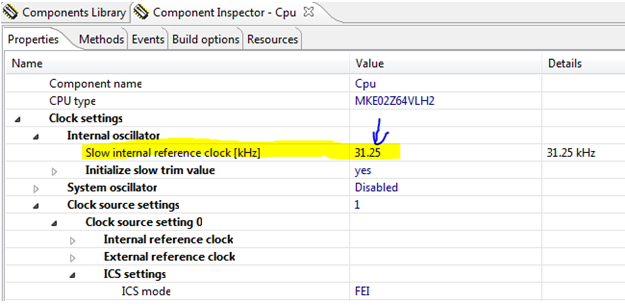

The internal reference clock can be trimmed also in program time of the device to any value between 31.25 and 39.062kHz, this allows also achieving exotic bus frequencies.
The value applied in Processor Expert does not propagate into Pemicro connection manager.
No matter if Processor expert is used or not , we need to configure it it by ourselves in connection of OSDA (same for debugging or programming). So this is a guide how to do so.

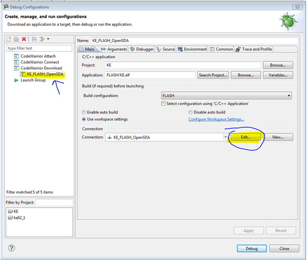

Then hit5560_5560.PNGVýstřižekBUG.PNG  flag, choose debug configuration and you will see configuration of your connectons, I have here only OSDA for my Kinetis E Freedom board (it is similar across families of Kinetis, ColdFire or S08 just connection would be SWD, Jtag or BDM)

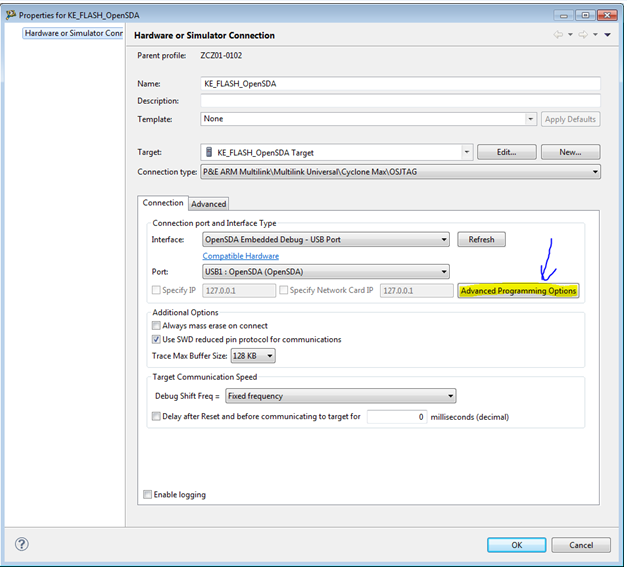

You will get new window

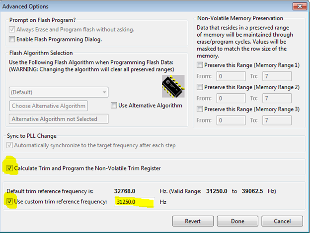

Choose „Advanced Programming Options“ button
Enable calculating of Trim value and programming into Flash location.
If the TRIM frequency is different from default, check the box to use custom one in valid range – the one you(or Processor Expert) have used for your timing calculations.
Hit DONE and your effort is done!
Next, when you will launch debugging session by hitting bug on button 5561_5561.PNGVýstřižekBUG.PNG these values will be applied.

ICS_C3 was trimmed to value of
0x57 for 39.062kHz and
0x9B for 31.250kHz
for my Kinetis E Freedom board.
Precision is better then 1% in room temp. This is ok for serial comunication without need of crystal for example.
Values out from my discovered range of 0x57 – 0x9B leads to frequencies that are out of specification of ICS and should not be used for this exact device.  The limits will be slightly different for every single device.
