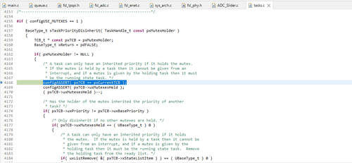

I am working on a program using LwIP generated by the configuration tools in FreeRTOS mode.
Here is what I have done so far:
  1. I opened an empty program project in the SDK.
  2. I added the middleware LwIP with the MCU Config Tool and FreeRTOS.
  3. I added vTaskStartScheduler to my main function, and my program ran without any problems with the tcip_thread task.
However, after that, I decided to add a network interface in LwIP using the MCU Config Tools. I included all the missing SDK components. After doing this, I encountered a FreeRTOS assert (Mutex Problem between tcip_thread and lwip_rx Tasks) without making any changes to my code.
Can anyone help me understand why this is happening and how to resolve it?

Hi @Sam_Gao,
Thank you for taking the time to look into my projects. Let me provide some additional details to help clarify the issue:
  1. Initial Project Setup:
    • I initially created a project with four FreeRTOS tasks using MCUXpresso.
    • At this stage, everything worked correctly.
  2. Adding LwIP:
    • I then added LwIP in FreeRTOS mode using the MCU Config Tools, initially without a network interface.
    • I relaunched my project in debug mode, paused it to verify each task, and confirmed that everything was functioning as expected.
  3. Adding Network Interface:
    • Afterward, I decided to add a network interface in LwIP using the MCU Config Tools.
    • I routed all the necessary pins and included all the missing SDK components.
    • After doing this, I encountered a FreeRTOS assert (mutex problem between tcip_thread and lwip_rx tasks) when I paused my program, without making any changes to my main code.
  4. Issue Encountered:
    • After adding the network interface, the project compiles and flashes correctly.
    • However, during execution, my other FreeRTOS tasks do not run, and the code gets stuck in the assert related to the mutex problem mentioned above when I pause the program.
  5. Steps Taken:
    • I created a blank project with only LwIP configured using the MCU Config Tools to isolate the issue.
    • Even in this minimal configuration, I encountered the same assertion problem.
    • I have tried the SDK examples for LwIP/TCPIP, and they work completely. However, I want to continue using the MCU Config Tool system to configure LwIP for my project.
  6. Current Main Code:
    • The main code in the LwIP blank project looks like this:
      int main(void)
          /* Init board hardware. */
          BOARD_ConfigMPU();
          BOARD_InitBootPins();
          BOARD_InitBootClocks();
          BOARD_InitBootPeripherals();
          BOARD_ENET_PHY_RESET;
          /* Update the core clock */
          SystemCoreClockUpdate();
          vTaskStartScheduler();
          /* Add user custom codes below */
          while (1)
    • This main function is essentially the default initialization code with FreeRTOS starting, and I have not added any custom user code yet.
Thank you for your assistance.

Hi @fabien251
Currently there are some issues about MCU Config Tools, I would like to recommend you to use workable SDK instead. And the issue of MCU config tools will be fixed in the following new version, but it may take long time.
Then for other feature, please continue using the MCU Config Tool if need, but please consider SDK if you still meet similar issues from MCU Config Tool.
B.R,
Sam

Hi @Sam_Gao ,
To fix this issue you need to exclude /lwip/doc folder of the project (another bug in MCUExpresso)
Fabien
