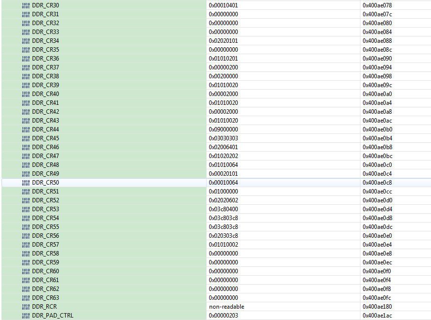

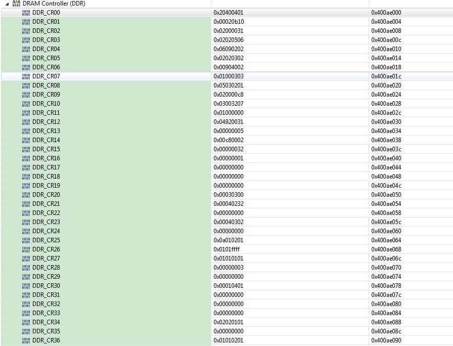

I have a strange problem with DDR.
Project specs:
Kinetis k61FX512
DDR part : MT46V16M16
Using the DDR init script provided in the sample. I have adapted it for DDR and above mentioned part.
I have written a temp function as:
  volatile uint8_t * u8ptrTmp = (uint8_t *) 0x080000F0;
  volatile uint8_t u8Tmp;
  volatile uint8_t u8TmpBuff[10];
  for(u8Tmp = 0 ; u8Tmp < 10 ; u8Tmp++)
  u8ptrTmp[u8Tmp] = u8Tmp;
  u8TmpBuff[u8Tmp] = u8ptrTmp[u8Tmp];
  for(;;);
Objective is to write 10 bytes starting at 0x08000000 & reading them back in a buffer.
The writing happens but very oddly, like:
0x080000F0 = 0x07
0x080000F1 = 0x06
0x080000F2 = 0x05
0x080000F3 = 0x04
0x080000F4 = 0x03
0x080000F5 = 0x02
0x080000F6 = 0x01
0x080000F7 = 0x00
And reading happens properly as in buffer shows 0x07, 0x06....0x00.
Tried changing endianness, but no luck. It results in
0x080000F0 = 0x04
0x080000F1 = 0x05
0x080000F2 = 0x06
0x080000F3 = 0x07
0x080000F4 = 0x00
0x080000F5 = 0x01
0x080000F6 = 0x02
0x080000F7 = 0x03

Attached are images of the same
I need to transfer & run code from DDR at bootup. So I need to be able to write & read sequentially byte by byte.
Kindly suggest if anymore details are required.
Thanks...

Hui_Ma
Besides of hardware connection issue, I think most caused by DDR controller registers setting.
Please check below pictures about TWR-K70F120M board DDR2 registers setting.
Wish it helps.
