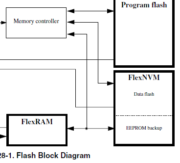

I'm sorry to steel your time but I have got another question... First I thought that the "normal" flash function is enough for my application but I'm writing my bachelor thesis and my prof wants to see the EEPROM emulation for some specific cases. For example he would like to see an error code saved in the flash. So to rewrite or erase the error code because of an exception I have to erase a whole sector of 1024 bytes -.- that's too much when I only have to change a few bytes... However, he would like to see the emulation... although I know that the byte write operation is possible with your uTasker code too :smileywink:
So I would like to implement a little sector using the EEPROM emulation. That should only be about 1 kByte or less. The rest I would like to use as "normal" flash like it works :smileyhappy:
Well, I have tried to implement it but I get some hardware faults... Could you tell me the initialization for the EEPROM emulation? I don't know how to partition the data flash space. Do I have to set some setting in the code warrior?
The next point is, that I'm not sure where the EEPROM space and the data flash sector begins, when I have configured it. When I look at the picture below, I think that the start address of the "normal" flash begins at 0x10000000. But is it right that the first EEPROM address is at 0x14000000 ?
Thank you!
Pascal

As you probably already know, 1k EEPROM will require 16k FlexNVM (leaving 16k for use as data Flash if required). This means that writing a few bytes in EEPROM will require 16k to be used. The emulation will also be erasing 1k sectors each time that values are modified. This means that in most cases data flash is not less efficient than EEPROM but quite a lot more efficient (in terms of storage requirements). Therefore I am assuming that use of EEPROM is an academic exercise and not an application requirement  becasue its main interest is when large amounts of small changes are to be made - > 50'000 for example where its reliability then has an advantage.
You should find the details in section 28.4.2.1 of the user's manual. As it informs there, the partition is written using a flash command 0x80. This is not in the flash interface that you have but can be added easily with a new switch case and then passing a buffer with the data size and partition code. The exact data to be sent is given in chapter 28.4.11.14. There si then a second command for the FlexRAM function (0x81), also described there.
Since I haven't used the EEPROM I don't know all details but I expect that the FlexRAM address area from 0x14000000 is used as EEPROM, with the EEPROm emulation taking place automatically between the FlexRAM buffer and the partitioned area of FlexNVM. I also expect that, if partitioned for 1k EEPROm the remaining FlexNVM in data mode will be accessible from 0x10004000 (after the area used by EEPROM). The best way to find out is to command the partition and the experimet with what happens.
Athough not for the EEPROM mode, I have attached a binary file that can be programmed to your board (FRDM-K20D50M). I have now added FlexNVM as data flash support to the uTasker project which makes its use simpler. Rather than need to know where the FleNVM is located, the flash interface routines make it look like it is extended to the end of program Flash. If you connect via Virtual COM to the UART at 115kBaud there is a new set of commands in the "Input/Output" menu as follows:

Hey Mark,
The EEPROM emulation works! :smileyhappy: but I have got two questions:
1.
For the very first time I have to patition the EEPROM size and the normal flash size like you know.
After that the device partition mustn't be changed anymore, because of device damage. But how can
I figure that the flash is already partitioned? I tried to trigger at the FTFL_FCNFG_EEERDY bit but this bit
isn't set after partitioning....

1. FTFL_FCNFG is a status register and resets to 0x00 therefore it is not intended to show the state of the partition (it is used to verify that operations have completed).
I believe that you need to read back the "partition code" and "data set size" from Data Flash IFR (see section 28.3.3) - command 0x03 in table 28-42,

I am not clear on exactly what you are asking but I suggest looking at the uParameterSystem: http://www.utasker.com/docs/uTasker/uTaskerFileSystem_3.PDF
All code needed for reading/writing internal Flash or external SPI Flash, with safe swap-block methods to avoid potential parameter loss when a reset/power down occurs during the process is included in the package here: http://www.utasker.com/forum/index.php?topic=1721.0
>>By the way I havn't got understood where are the differences between using the flash and the EEE (EEPROM)?!
I think the main difference is that you can modify a single byte in EEPROM but you can't in Flash - you need to delete a complete Flash sector to change a value that has already been written. Also, the Kinetis supports either long word or phrase writes (4 or 8 bytes, depending on processor type) so the smallest write size is this and not a byte. Flash writes are usually faster than EEPROM writes - a write to Flash may take 50..100us but a write to EEPROM may take up to 2ms.
Mark
