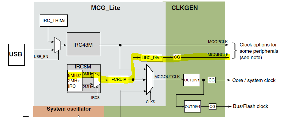

I am new to MCUExpresso, and I am having difficulty with a TPM Timer.  I looked over the example and the SDK and attempted to implement it on my board, but I can not get the timer to count, let alone interrupt.  I have attached a screen shot of the clocks table and below are the parts of my code dealing with the TPM module.

For the life of me I can not find where the issue is with this, I checked my TPM settings against the user manual and they all look good.  All I can figure is somewhere I have an issue with using the MCGIRCLK vs the    MCGPCLK / HIRC.  I have no need for 48MHz and may eventually even step down to the external clock to reduce power once things are dialed in.
Any help would be appreciated.

If you want to use the 8MHz IRC as TPM clock make sure that you enable it and its clock gate.
The code to do this is
MCG_C1 |= (MCG_C1_IRCLKEN | MCG_C1_IREFSTEN);                // enable internal reference clock and allow it to continue running in stop modes
MCG_SC = 0;                                                  // remove fast IRC divider
MCG_C2 |= MCG_C2_IRCS;                                       // select fast internal reference clock (8MHz)
SIM_SOPT2 |= SIM_SOPT2_TPMSRC_MCGIRCLK;                      // use MCGIRCLK as timer clock source

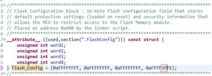

umlengineer
Better late than never.  The solution to this was disabling the NMI pin in startup_mkl17z644.c.
To do this you need to change the byte shown in the image from 0x3D to 0x3F within startup_mkl17z644.c
Thanks!
