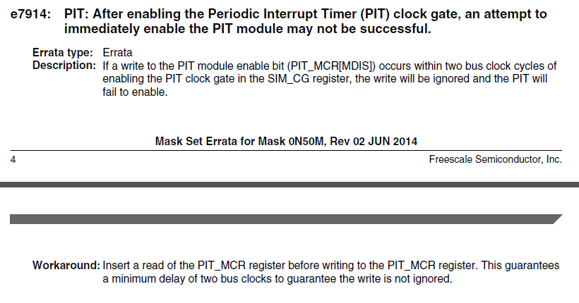

Hi Charles
See Errata to the mask 0M50M (valid for the K22)
Code from uTasker framework:
    POWER_UP(6, SIM_SCGC6_PIT);   // ensure the PIT module is powered up
    #if defined ERRATA_ID_7914
    (void)PIT_MCR;                // dummy read of PIT_MCR to guaranty a minimum delay of two bus cycles after enabling the clock gate and not losing next write
    #endif
    PIT_MCR = 0;                  // ensure the PIT module is clocked
Mark
