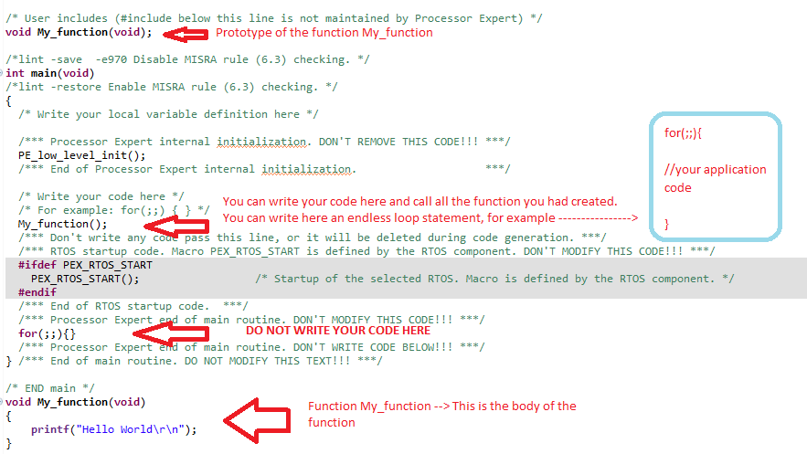

I just got my KL46Z, and Ive been noticing that in the main.c file there are a lot of comments telling me not to edit this and that part of the code, also I can't just put code where I want, so where do I write my functions? I'm gonna need them to simplify my code.
I set Processor expert, OpenSDA, Bareboard for the project options (if You need that info).

Hi Kiven,
You can see in the image below how to manage your own function in processor expert code. Write your function in any other part out from the main function, then you have to add the prototype of the function just like a global variable. You can use your function in any part of your code, I hope the image explains all clearly.
Where says "Do not write your code here" it is because this for the use of PE, just a security measure. If you write your code there every-time you generate new code with Processor Expert all the code that is written there will be erased.
I hope this information can help you.

kiven
Muchísimas gracias! Es exactamente lo que buscaba!
Aprecio tu respuesta. Hay alguna manera de mantenernos en contacto? soy nuevo en esto y me gustaría contar con alguien que pudiera resolver una que otra pregunta, claro, si es que quieres y puedes. Gracias de todas formas!

ankur_kala
Hi Kiven,
When you generate a bareboard project using Processor expert, you would generally find a processorexpert.c file containing the main() function.
/*lint -save  -e970 Disable MISRA rule (6.3) checking. */
int main(void)
/*lint -restore Enable MISRA rule (6.3) checking. */
  /* Write your local variable definition here */
------------------------------------------------------------------------------------------------------------------------------------------you can add your local variable definitions here
  /*** Processor Expert internal initialization. DON'T REMOVE THIS CODE!!! ***/
  PE_low_level_init();
  /*** End of Processor Expert internal initialization.                    ***/
  /* Write your code here */
  /* For example: for(;;) { } */
  /*** Don't write any code pass this line, or it will be deleted during code generation. ***/
  /*** RTOS startup code. Macro PEX_RTOS_START is defined by the RTOS component. DON'T MODIFY THIS CODE!!! ***/
  #ifdef PEX_RTOS_START
    PEX_RTOS_START();                  /* Startup of the selected RTOS. Macro is defined by the RTOS component. */
  #endif
  /*** End of RTOS startup code.  ***/
  /*** Processor Expert end of main routine. DON'T MODIFY THIS CODE!!! ***/
  for(;;){}             ---------------------------------------------------------------------------------------------------------------you can write your code here
  /*** Processor Expert end of main routine. DON'T WRITE CODE BELOW!!! ***/
} /*** End of main routine. DO NOT MODIFY THIS TEXT!!! ***/
Hope this solves what you were looking for. :smileyhappy:

kiven
Hey, thank you for your response.
I wanted to know where should i put my functions, their prototypes and all that stuff.
I experimented and found that you can declare and define them below the include list just like a normal C file.
Thank you, tho! :smileygrin:

Hi Kiven,
For sure you can work like a normal C file. Only point to be taken care is that if your functions are defined below from where they are called then you would have to declare those functions at the start. For eg.
int sum (int a, int b);
main
  int var1, var2, result;
  result = sum (var1, var2);
int sum(int a, int b)
     int result;
     result= a+b;
     return result ;
this way you wont find any issue. However if the function is not declared at the start, compiler may give error.
