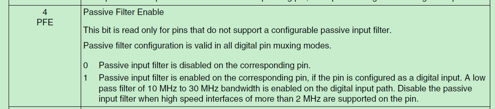

Hui_Ma
Please get related feature description at Pin Control Register n (PORTx_PCRn) [PFE] bit description:
Wish it helps.
Ma Hui

aberger
Senior Contributor I
Regarding the screenshot you shared from the K60 Reference Manual... do the same specs apply to the K64? In the K64 Sub-Family Reference Manual, it does not specify the passive filter bandwidth, and I was unable to find any further info in the K64 Sub-Family Data Sheet.
PORTx_PCRn field descriptions:
k64‌ low pass filter‌ #port configuration

Hui_Ma
Please check the K60_100MHz reference manual about related info.
Wish it helps.
Ma Hui
