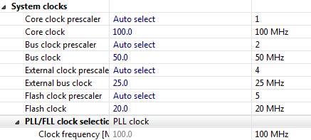

albertovargas
I generated a project using MQX and Processor Expert. This is the configuration for System Clocks
And this is the generated code for CMT.c
