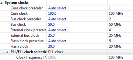

albertovargas
I generated a project using MQX and Processor Expert. This is the configuration for System Clocks
And this is the generated code for CMT.c

**             Primary prescaler divider                  : divide by 1
**              Clock divide prescaler                     : divide by 1
**              Input clock freqency                       : 50 MHz
