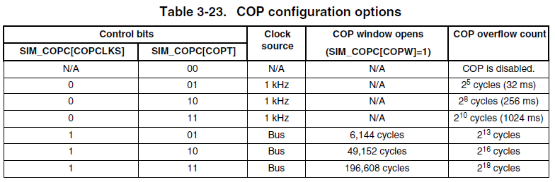

I was trying to find something in the documents provided by freescale and also sample BSP provided by freescale. I wanted to use watchdog timer for my project. Can someone please help me with a sample code of watchdog timer initialisation, setting the timer and using it.
Please post me some example to learn watchdog functioning on freedom kl26 board.

The watchdog or COP (Computer Operating Properly) in KL26 is very simple and not hard to configure. You only need to configure the SIM_COPC register according to Table 3-23 COP configuration options in the KL26 Reference Manual:
In the example code below for FRDM-KL26 the COP is configured for a 1 second timeout. If you compile with the macro RESET_WDOG = 0 the blue LED will toggle each second because the MCU is resetting. Otherwise if you compile with RESET_WDOG = 1, the counter is refreshed in the while loop and the MCU does not reset.
:smileyalert: Make sure that the SIM_COPC is not written in the startup code of the project. Typically the watchdog is disabled at startup and this register can only be written once after reset.

    SIM_COPC = 0xC; // COPT = 11    [Timeout after 2^10 LPO cycles] OR [Timeout after 2^18 bus clock cycles]
                    // COPCLKS = 0    [LPO (1kHz) clock selected]
                    // COPW = 0        [Normal mode]
                    // Timeout = (1/LPO clock) x 2^10 = (1/1 kHz) x 2^18 = 1 s
