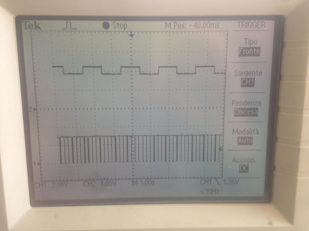

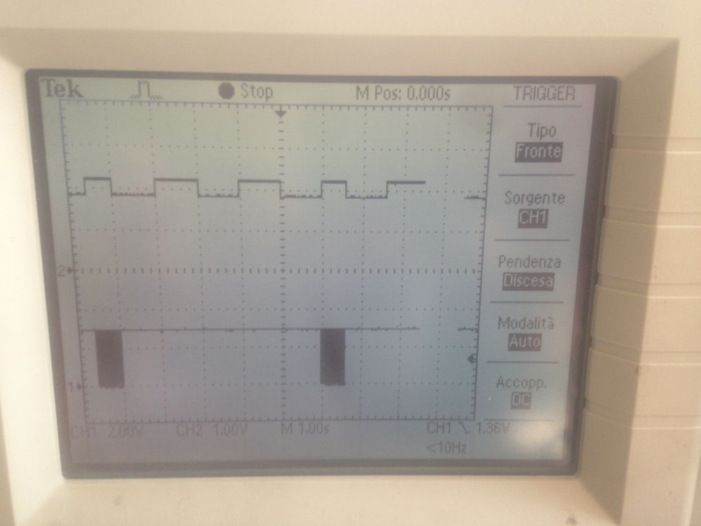

Using an oscilloscope to check the toggle of LED1 (which is done before the clear of the WD), the reset occurs before the timeout period elapses (resets at ~750ms), as you can see from this image (channel 2 is the LED1, channel 1 is the acceleromeer interrupt data ready pin at 2khz).
The strange thing is that If I change the data ready interrupt frequency of the acceloremeter from 2khz to 250hz, the program is working correctly w/o resetting, as you can see from the next image.
It seems that the MCU doesn't like waking up from LLS too fast (is really 2khz too fast, compared with the core clock running at 96mhz?) when the WD is enabled.
If the watchdog is disabled, no problems occur.
Another strange thing: changing watchdog timeout period from 1200ms to 2500ms (with interrupt @2khz), everything works correctly.
Has anyone ever noticed a problem like this?

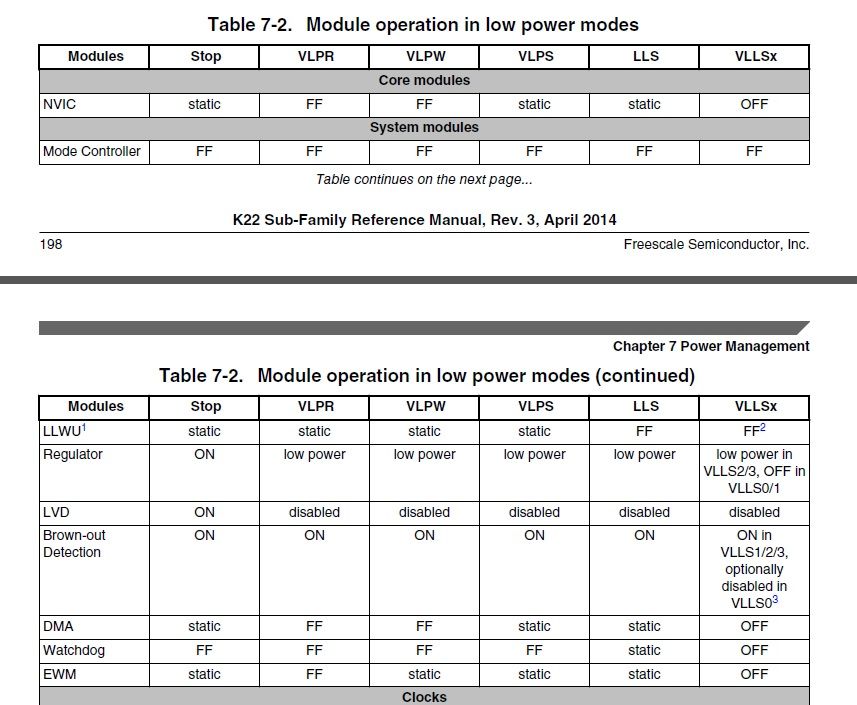

after consulting with a Freescale Field Application Engineer, we probably figured out what were the problems.
First of all, watchdog module is not Full Functionality in LLS mode but is instead static (module register states and associated memories are retained) as reported in the datasheet.
So it's correct that in LLS watchdog is not couting.
