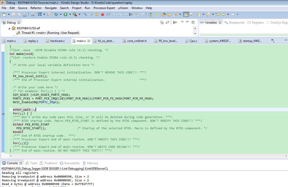

Hi Scott,
    I already get your project, and test it on my side.
    After I modified your code, and just test the enter_wait() function, I didn't find your problem on my side.
    Take care, when you do debugging in the wait mode, just use the resum(full run) instead of the step in.

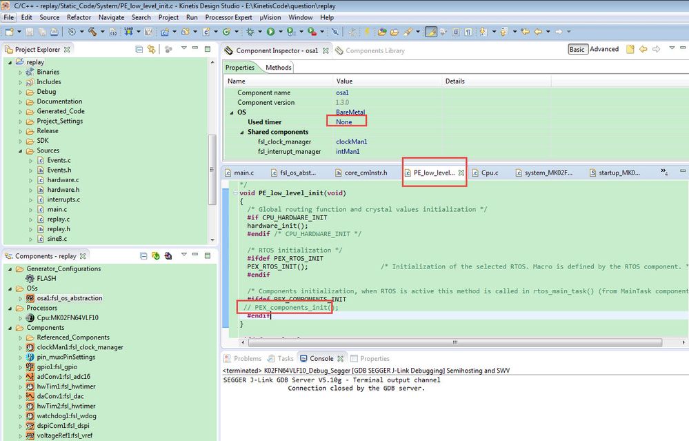

    If enter the wait mode, the code will wait the wakeup happens, as you know, any interrupt will wake up the wait mode, then the code will continue to run the code below the enter_wait() function.
    After I check your code, I find  you enable the systick in the OS, if you enable this module, the systick interrupt will happen, and it will wakeup the wait mode automatically, so I suggest you choose the used timer as NONE, just like the following picture, it also include the code I modified.
After the modification, the code runs ok on my side.
Beside, I also help you create a KDS project which just have the enter_wait function and the PTC1 falling interrupt wakeup.
Please find my test project from the attachment.
Following is my test result.
1. enter in the wait mode, the code won't stop, just wait the wakeup happens:
2, after I press the button, which just make PTC1 has a falling edge, then it will enter in the PTC1 interrupt , this interrupt will wake up the wait mode, you can find the code will run to the for(;;) which below etner_wait();
You can find all the process  the debug works ok, and there has none error or reset happen.
Please use my project, and test it on your side!
Wish it helps you!

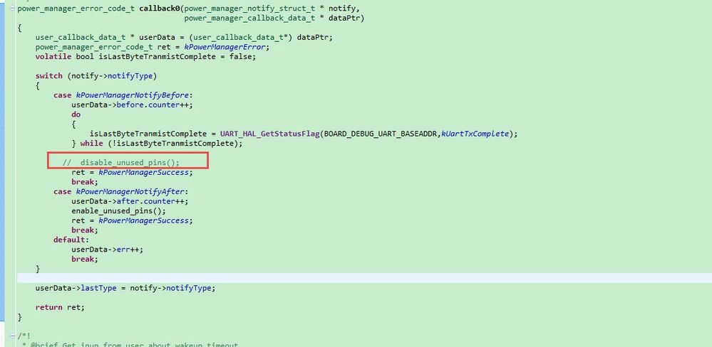

1. Debugger lost when enter WAIT mode
  If you use the POWER_SYS_SetMode(1, kPowerManagerPolicyAgreement); to enter in the WAIT mode, actually, just like what I have said, WAIT mode won't disconnect the debugger, except you disable the SWD interface with code.
  When you do step debugging in POWER_SYS_SetMode, did you meet this code:
  disable_unused_pins();
void disable_unused_pins(void)
  /* Disable debug pins when MCU sleeps */
  setup_debug_pins(kPortPinDisabled);
  /* Disable uart pins */
  setup_uart_pins(kPortPinDisabled);
If yes, please comment it, this code is used to disable the SWD debug interface and the uart interface.
I already check it with the KSDK1.3.0 sample code with our FRDMK22:C:\Freescale\KSDK_1.3.0\examples\frdmk22f\demo_apps\power_manager_hal_demo
After I comment code disable_unused_pins();, even I enter in the WAIT mode with debugger, the debugger still can be connected, and after the WAIT mode is wakeup, the debugger can enter in the RUN mode again.

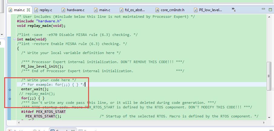

2.The most efficient WAIT mode entry procedure
  Yes, you are correct, the KSDK code is really long, complicate.
  If you want to enter in the WAIT mode, actually, you don't need to call all that functions, the KSDK is the full function for all the low power code.
You can write your own simplified code.
Take an example:
void enter_wait()
    volatile uint32_t dummyRead;
            SCB->SCR &= ~SCB_SCR_SLEEPDEEP_Msk;
            * Ensure that all register writes associated with setting up the
            * low power mode being entered have completed before the MCU enters
            * the low power mode.
            dummyRead = SMC_RD_PMCTRL(SMC);
            dummyRead = dummyRead;
            __WFI();
Then just call enter_wait() instead of POWER_SYS_SetMode(1, kPowerManagerPolicyAgreement);
Please use my code and try again!
