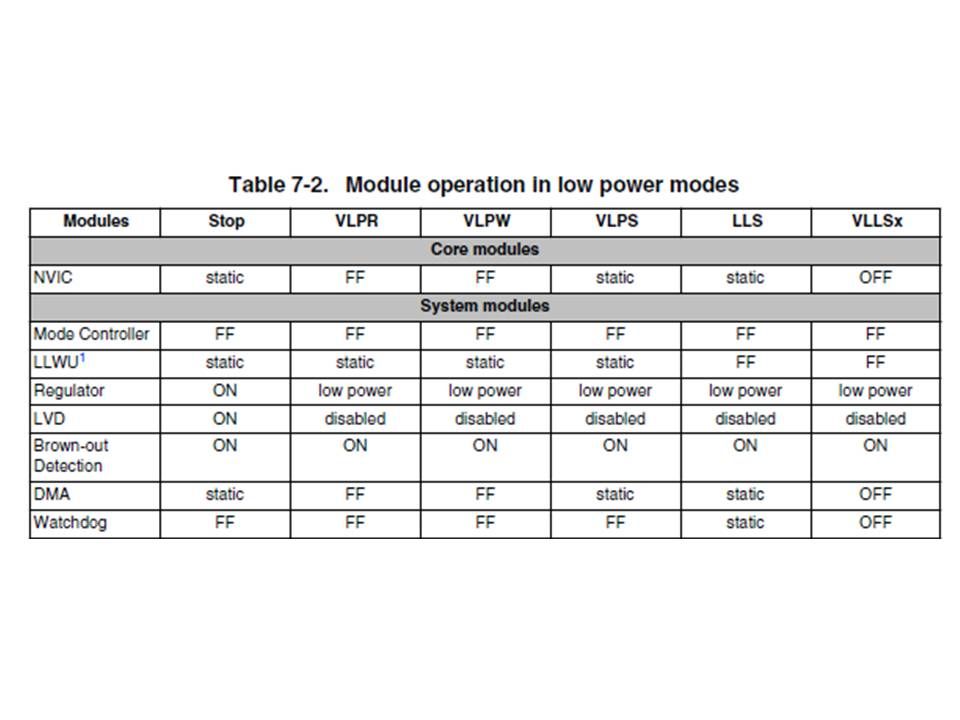

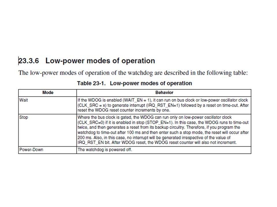

Now I've implemented the VLLS3 after disable the WDG. I still get the WDG resets.... I'm a little bit confused because of this two comments in the manual:
Here the WDG should be powered off in VLLS3.
And here it still will be working in VLLS3. - If I understand correctly (the STOP_EN is set). I'm using the LPO.
When I've a look at my behavior, it looks like the Stop description in 23.3.6.
I can read the WDG as the reset source in the SRS register, but the WDG reset counter doesn't increase....
Now I've tested it with STOP_EN not set, but I get the same behavior....
