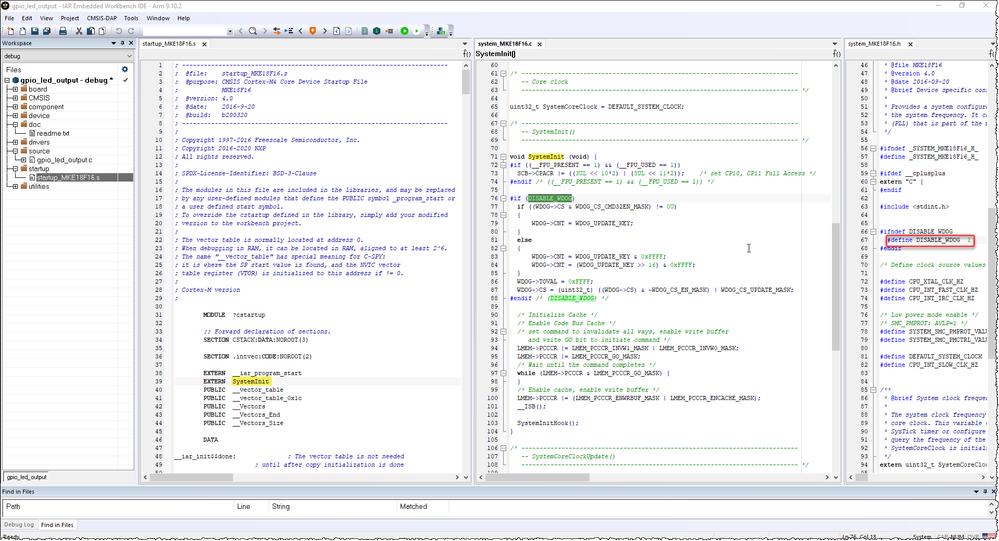

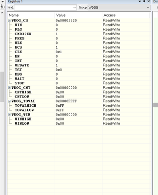

I am looking into the WDOG peripheral and the KE1xF rev 4 reference manual says that the WDOG_CS[EN] bit is set to 1 at startup.  However I see the EN bit set to 0 at startup.
I am using IAR to debug, and I have not ruled out IAR not displaying the registers correctly.  I have also noticed that if my software does not configure the WDOG at all (use start up values) I see my software running perfectly with no issues (even though I am not refreshing the WDOG and it is supposedly enabled out of reset).  However, once I run the software without the debugger, it seems the system is just resetting and no longer outputting any data.  I assume because the WDOG keeps resetting it.  I also tried setting the WDOG_CS[DBG] bit, but that made the IAR debugger not run any more.  Anyone else have issues with IAR and the WODG?
What I am trying to do is witness what the register values of the WDOG are if you do not configure the watchdog properly in time.  The manual says to write to the CS and TOVAL registers to have a successful configuration, but what happens if I only write TOVAL.  Will TOVAL then reset back to 0x400 like the manual says the startup value is?

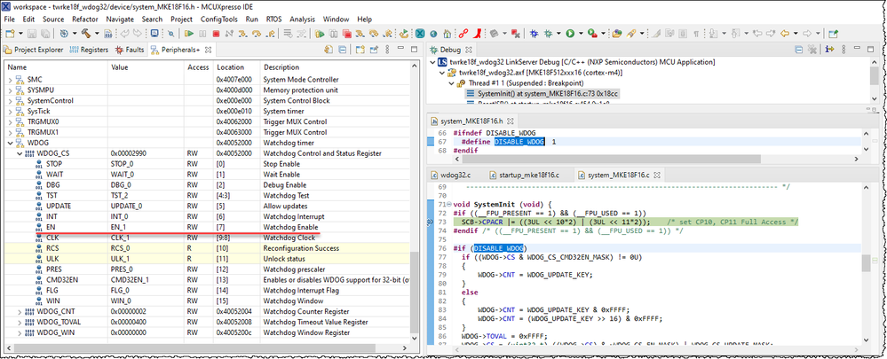

I don't know why the value of WDOG_CS[EN] will be 0 in IAR, since it was 1 in MCUXpresso IDE.
I am using TWR-KE18F, using CMSIS-DAP and JLink debugger get the same value 0 in IAR.

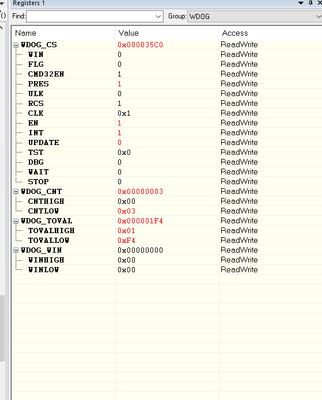

I am not sure what is going on with IAR.  When I set the debugger up to not run to main, and step through the system_MKE18F16.c code, the values in the register file are not correct according to the reference manual.
These are the values I see before running any code in the system_MKE18F16.c file.  It seems as if the values that are inside the #if (DISABLE_WDOG) are somehow showing up in the register fields.
In the code that I am executing, I set the DISABLE_WDOG to 0, and give it my own configuration of this:
Not sure why I can't see the startup values that in the reference manual.
