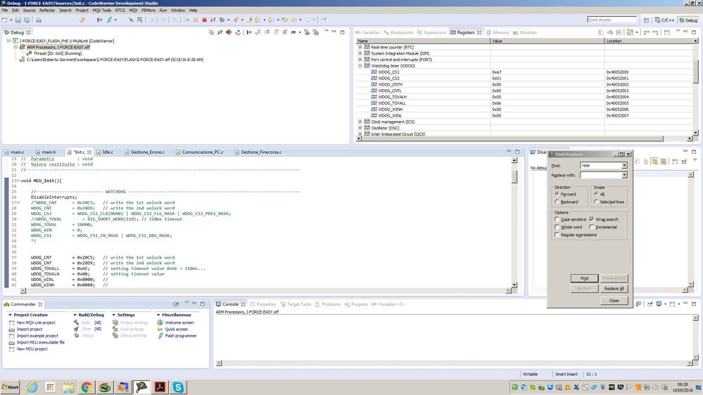

mjbcswitzerland
Specialist V
Roberto
I have never had probems with the watchdog on any KE or KEA parts apart form first tests where it may have been identified that the short work access is importantant also the fact that the example in the user's manual is wrong...
Ths is reported and discussed also in other threads:
https://community.nxp.com/message/498593?commentID=498593#comment-498593
https://community.nxp.com/message/501132?commentID=501132#comment-501132
Beware also that if the initial code disabled the watchdog but doesn't set the CS1[UPDATE] to a 1 it means that it is not possible to modify it again - it will always remain disabled whatever you do...
Mark

robertogiovinet
Hello Mark,
I tried in these days to manage WDOG, but I didn't do any goal: nothing changed.
You told me about CS1[UPDATE] bit but I knew it, so it was one of the first things I've checked. As you can see in the imagine below, registers are well setting! Values that I expected are in the registers, but counter don't start and so I don't have any reset. I disabled in __init_hardware() the part of the WDOG, so here you can see the only WDOG implementation in the code.
I read discussions in the links you gave me, but I didn't find anything that could be useful. I don't understand what's the matter, if there's anything else to set or maybe  a particular register that I didn't set correctly. I don't know... I always used WDOG in my projects in the past and I didn't experienced this troubles.
Thank you very much
Roberto
