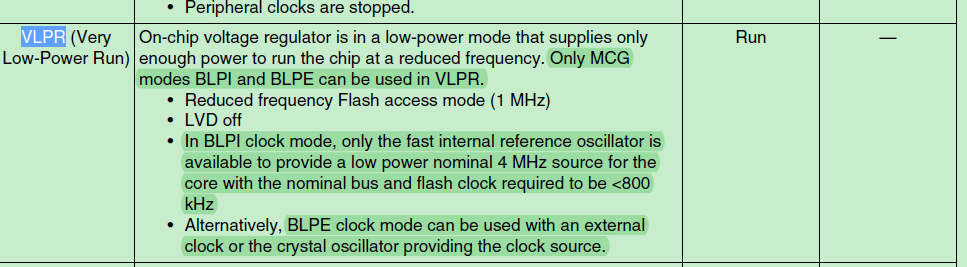

  From the KL26 reference manual you can get:
Only BLPI and BLPE can be used in VLPR.
 From your code, I didn't find that code, and the VLPR enter code.
