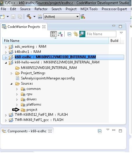

abdullahansari
Hi perla,
What I meant is, though i have source file in the project for EsDHC but for k60 helloworld project, it doesnt show any source (.c or .h) files. The folder shows an exclamation mark in codewarrior environment only for hello world project. I dont see either the source files for hello world project in (My download file)/src. It contains only esdhc.c, esdhc.h, isr.c and isr.h..
What I predict is hello word project would write some strings onto the sectors of memory card. heloword.jpg
