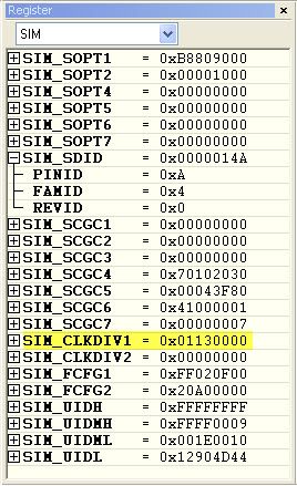

For example, to verify the core clock frequency, and use the PWM method above, the PWM will measure half the peripheral Bus clock frequency.  From the diagram above, the Bus clock and core clock are derived from the same clock source, which is the MCGOUTCLK signal, but they have separate clock dividers, boxed in red above.  You can use the debugger to verify the clock dividers at run-time.
Attached is a project to show how these clocks can be verified.  This example uses a 100MHz K60, but the code can be easily ported to other Kinetis derivatives or toolchains.  This project will work on either of the Tower boards TWR-K60N512 or TWR-K60D100M.  The startup code uses the PLL to generate MCGOUTCLK of 96MHz.  The screenshot of the clock dividers above shows SIM_CLKDIV1 = 0x0113_0000, which means:
  • core/system clock divider is 1, or 96MHz
  • peripheral Bus clock divider is 2, or 48MHz
  • FlexBus clock divider is 2, or 48MHz
  • Flash clock divider is 4, or 24MHz
