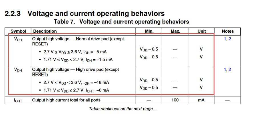

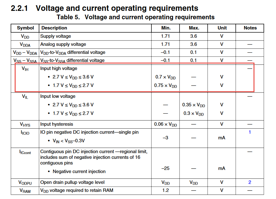

Hi there,
      I am using mkl25z128vlk4 in one of my project. I want to drive the controller at 2.8V in my circuit to avoid level conversion required if i drive the same @3.3V. I want to know whether the gpio high voltage level is equal to vdd . i.e if I am applying 2.8V at Vdd pin will the gpio high level be 2.8V. I am kind of new with this controller and on a tight schedule. Any kind of help is appreciated.

     About the higher level in the MCU, you can find it in the KL25 datasheet.
   http://www.nxp.com/files/32bit/doc/data_sheet/KL25P80M48SF0.pdf?fasp=1&WT_TYPE=Data%20Sheets&WT_VEND...
    The input high voltage:
   The output high level:
