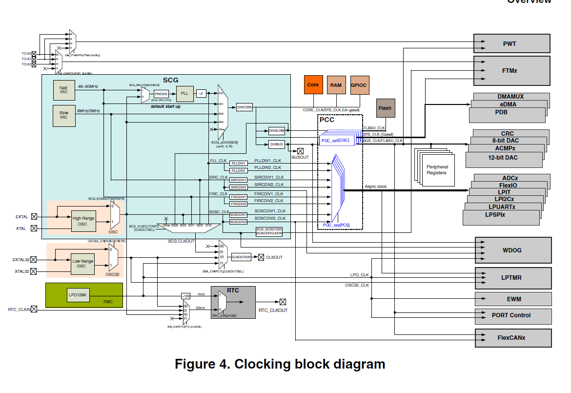

I have a MKE18 TWR development board and I would like to use the internal clock instead of the external 8MHz clock.
If I look at the block diagrams in the datasheet it should be possible, see attachment for the clocking diagram. I would like to get 120MHz system clock.

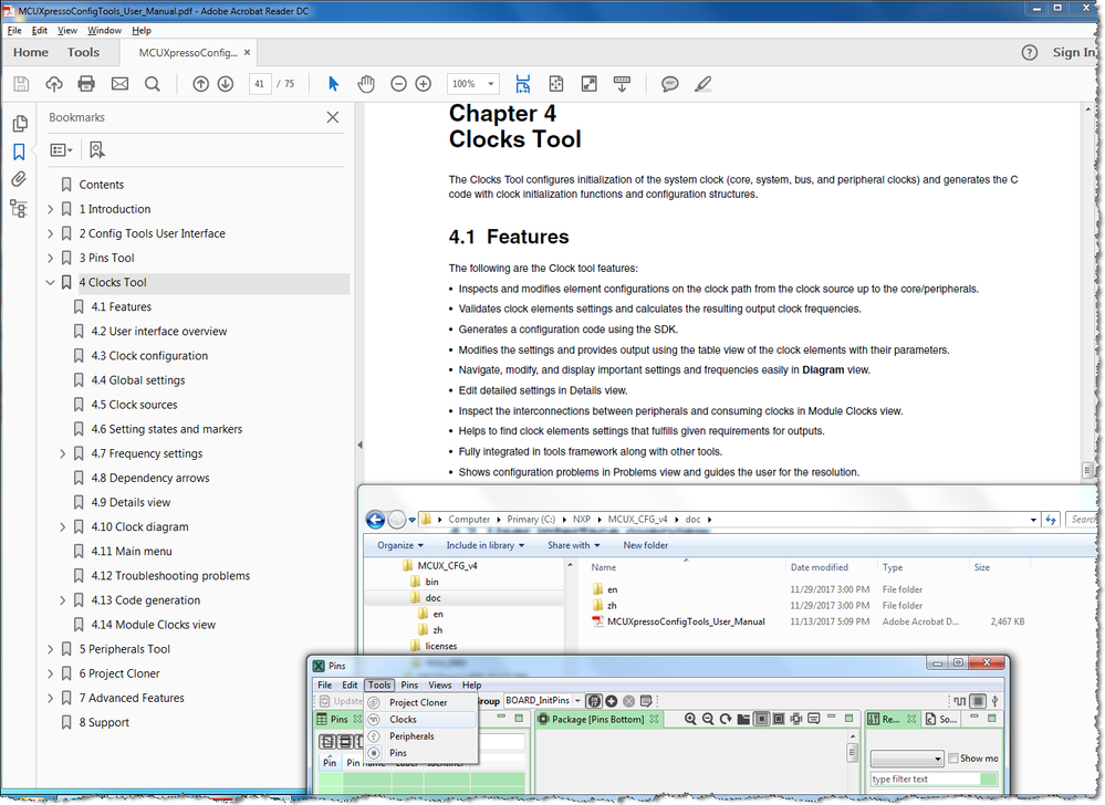

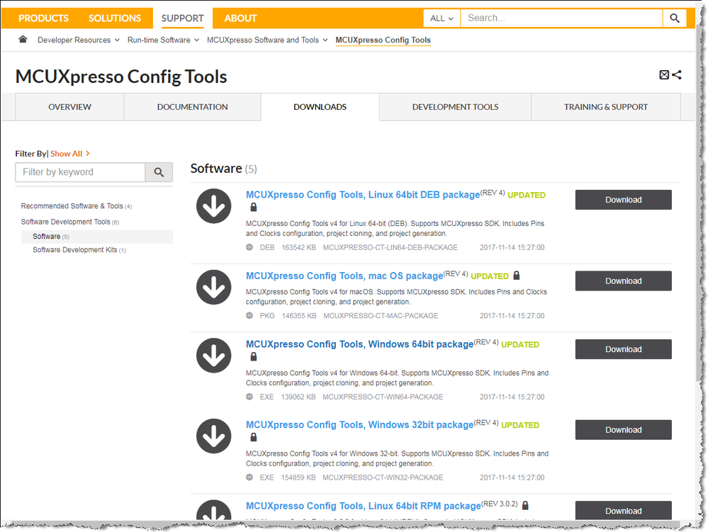

Robin_Shen
You can download the standalone MCUXpresso Config Tools, and read the "Chapter 4 Clocks Tool" of MCUXpressoConfigTools_User_Manual.
