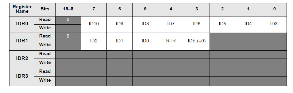

Assume that you set the IDAM bits as 00 in binary, the "Two 32-bit acceptance filters" pattern filter is used because there are two bank.
Assume you use 11 bits standard pattern, I think you can use the following pattern for the first/second bank:

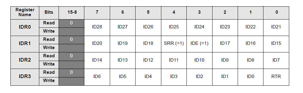

If you use 29 bits extended ID, you can use the following pattern for first/second bank:
I copy the figure from RM of MC56F80x, they are all use MSCAN, the patten is the same.

For example if I only what to pass the messages with the ID 0x55 (standard id), waht do I need to put in the first bank registers (
MSCAN_CANIDAR0~3,MSCAN_CANIDMR0~3)?
Emilio
4,386件の閲覧回数
xiangjun_rong
Hi, Emilio,
The MSCAN_IDARx register and the MSCAN_RSIDRx register match each other, if you set the received ID as 0x55(the ID bits is 000 0101 0101), and set the IDAM bits as 00, you can set as following:
MSCAN_CANIDAR0=0x0C; //it include ID10~3
MSCAN_CANIDAR1=0xC0  //it includes ID2~0
You can set the MSCAN_CANIDMR0=0xFF; MSCAN_CANIDMR1=0xF8;
It is okay.
