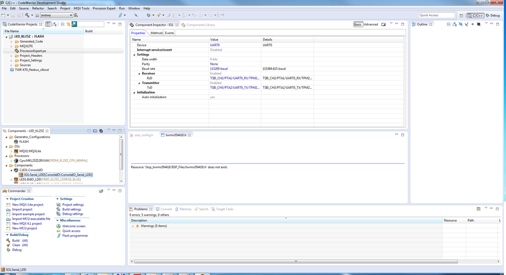

I a working on a project where we are using "mkl26z256vlh4" processor. I am trying to get some debug data through a UART on a PC. I am following this guide Tutorial: Printf() with (and without) Processor Expert | MCU on Eclipse .
This worked when I was using the same hardware without MQXLite RTOS. But when I use it with MQXLIte I get some build errors,shown in the attachments.
Is there any way I can still use ConsoleIO component to get the debug data through UART?

I found there is already a MQX Lite demo based on FRDM-KL25Z , which uses ConsoleIO component to get the debug data through UART, so I think you may use that demo as a starting point. The project can be found in the fold of "C:\Freescale\CW MCU v10.6\MCU\CodeWarrior_Examples\Processor_Expert\MQXLite\Kinetis\FRDM_KL25Z\LED_KL25Z" Please kindly refer to the following for more details.
Hope that helps,
Kan

Thanks for your answer , will check out this solution. Talking to my colleague who started this project, he thinks he selected "No I/O" instead of "UART" while creating this project.taht could be the issue.
