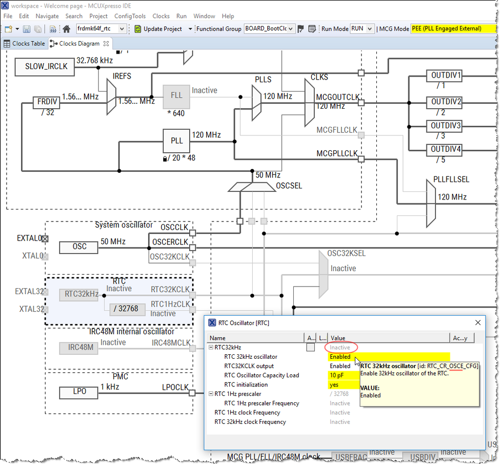

I am using MCUXpresso and it's config tools. Currently my target is MK64FX MCU Teensy 3.5 board but I am using examples from FRDM-K64F board . I configured Teensy board clocks to max 120MHz and to use RTC module with external 32MHz oscillator. The imported project rtc_func from FRDM-K64 board examples functions as described on my Teensy but I think that example is not using RTC module / external oscillator, but rather internal source MCGIRCLK.
Can somebody point me to a right clock configuration used with Clock Config tool which routes true RTC clock from RTC module to be used for any RTC application?

Mark, unfortunately you are absolutely right in your conclusion :smileysad: The MCUXpresso as a tool is probably the best tool for the development in terms of good overall architecture and integration of the toolchain, I was glad to discover it...but ... evidently has loose unfinished ends... might not be ready for a large project...
I don't stuck waiting for a particular solution (many tasks at hand running in parallel), yet you are right - there is no good reason for such a powerful tool as Clock config tool to not complete the routing of the real time external oscillator to all the internal on-chip circuits.
BTW, STM32CubeMX completes this job easily in a graphical config.. I did not even need to study documentation on that....

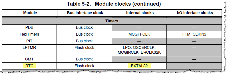

The RTC module can not select the internal source MCGIRCLK, EXTAL32 is the internal clocks of RTC.

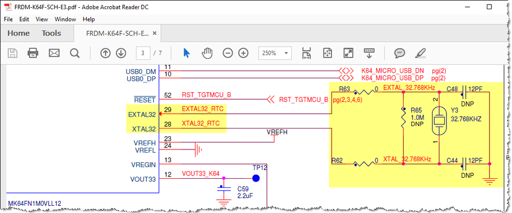

The RTC module use external 32.768KHz crystal. (Teensy 3.5 also connect 32.768KHz crystal at EXTAL32 and XTAL32 pins.)

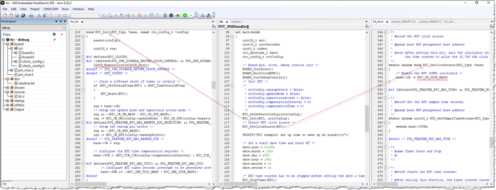

I import the rtc SDK_2.4.0_FRDM-K64F example into MCUXpresso IDE.
Then open the Clocks view of ConfigTools, I can see the Inactive shown at RTC although the RTC_CR[OSCE] has been enabled.

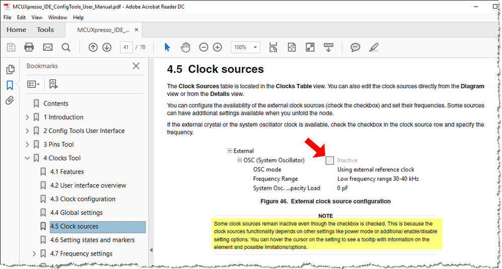

There is a NOTE in MCUXpresso_IDE_ConfigTools_User_Manual, which can be used to explain.

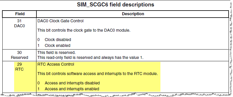

The SIM_SCGC6[RTC] controls software access and interrupts to the RTC module, the Clocks of ConfigTools did not enable it.
It was enabled in RTC_Init() function,you can find it in rtc.c files.

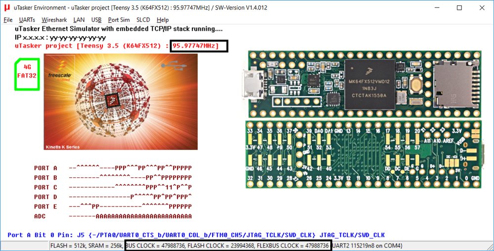

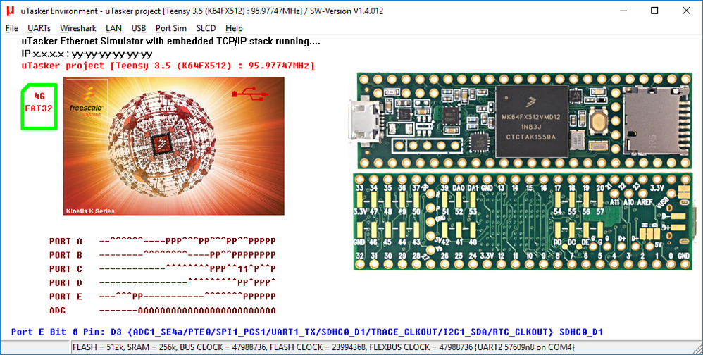

I'll do another test:
- I just took the project and modified the same RTC setting for a TEENSY-3.5 (your HW).
- Then I did a couple of other configurations to add a FAT file system with the SD card, plus a command line interface on the USB interface (USB-CDC) as composite with USB-MSD so that the SD card appears as an external hard drive when connected.
- I build it with GCC and simulated it in Visual Studio to check some basics (see screen shot below where the simulation confirms USB operation, the clock speeds and the SD card pin out
- I have attached the HEX file that can be loaded to a real TEENS 3.5 board for anyone who wants to try it.
I don't actually have a TEENSY 3.5 so I can't test (and be 100% sure) but I do expect it to operate with a high probability (there are various Teensy 3.5 and Teensy 3.6 users of the project who have confirmed full functionality and especially the uTasker serial loader is used by many Teensy 3.1, Teensy 3.5 and Teensy 3.6 projects or products derived from them).
Furthermore, if I decide to do the same on a teensy 3.6 (K66) I can change a single define (TEENSY_3_5 to TEENSY_3_6) and the complete HAL will switch to the other chip and HW (I can do the same for about 60 standard Kinetis boards/chips too). I timed the work to be under 5 minutes so if it were to fail I would have a little reserve to debug something if necessary.

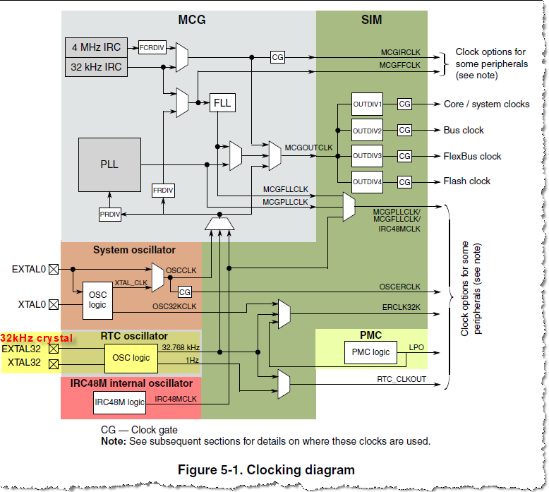

Robin_Shen
Sorry, my last reply may be misunderstood!
I just want to tell you that RTC example is using 32kHz external crystal with internal RTC oscillator, the connection between 32kHz external crystal and K64 is same as Teensy 3.5 board.(Both FRDM-K64F and Teensy 3.5 connect 32kHz external crystal at EXTAL32 and XTAL32 pins.)
Due to you said "but I think that example is not using RTC module / external oscillator, but rather internal source MCGIRCLK."
In fact that example is using RTC module / external 32kHz crystal with internal RTC oscillator, not the internal source MCGIRCLK.

Robin, how I suppose to understand your message earlier saying "That example is not using RTC module / MCGIRCLK."  ? You reversed it...
How does the "Clocking Diagram" picture in this post relate to the RTC code example we discuss? Where did you get this diagram from ?
THe hardware diagrams show hardware connections of the oscillator crystals to the respective boards FRDM-K64 and another Teensy 3.5 . I am well aware of this. But the subject here is whether software examples are indeed using this hardware RTC feature.  You know hardware feature might be or might not be used in the software. THat's why we need a code example showing such usage. I don;t see anything in your post that points to such configuration of the software driver.
