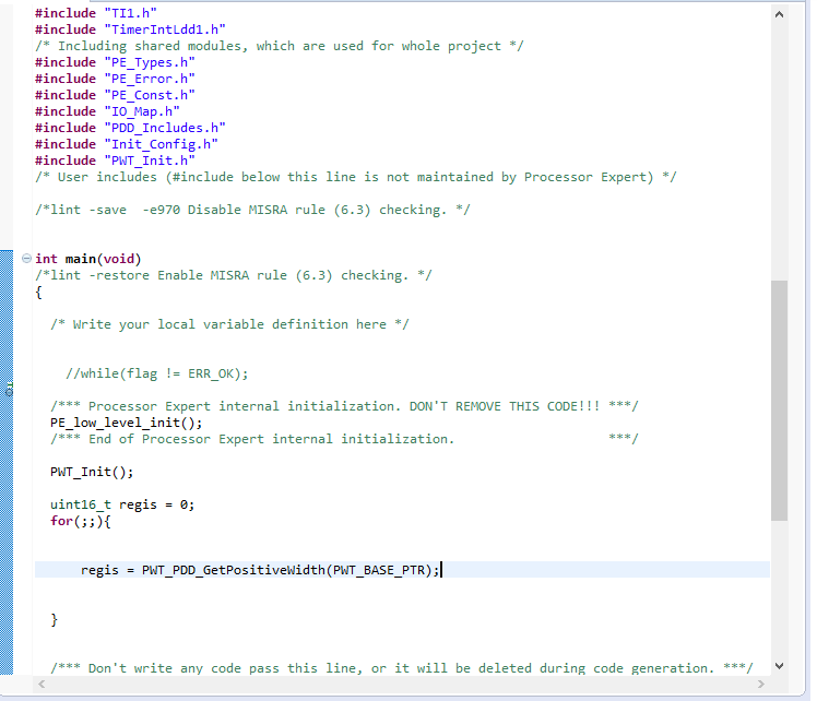

Hi everyone, i don't get PWT work,i must initialize module and get result of PPW with function PWT_PDD_GetPositiveWidth(PWT_BASE_PTR), REALLY?¿ o don't need interrupts here, i need get value by polling, i found this code:
Its look like a lot basic, how can use correctly?¿
I need get positive pulse width by polling,so i tought only init component and get its value.
Have a sample code somebody?¿

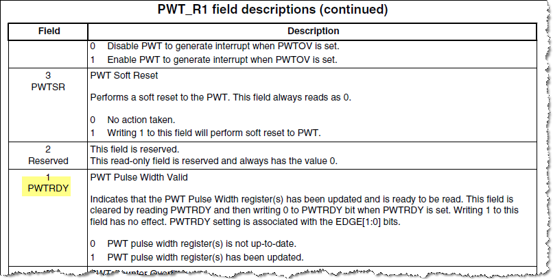

You may need to polling check the state of PWT_R1[PWTRDY].

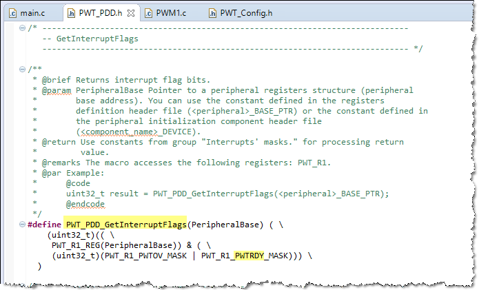

PWT_PDD_GetInterruptFlags function can be used.

For more detail, please read "27.4.2 Edge detection and capture control" of MKE04P80M48SF0RM.
