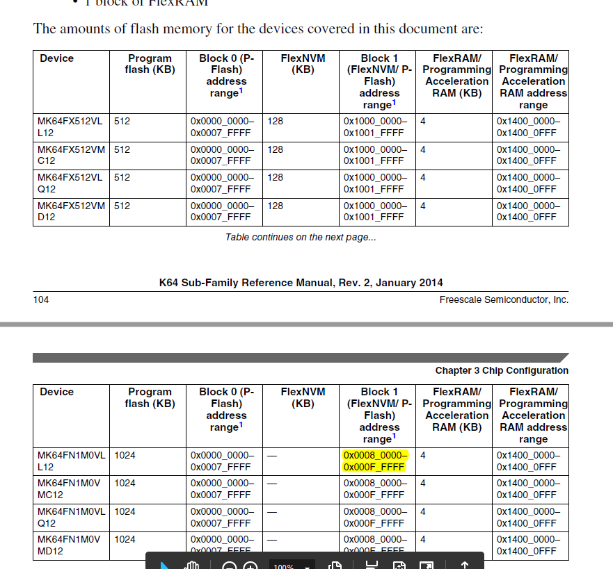

I am using the TWR-K64F (specific chip = MK64FN1M0VMD12). This chip is listed as having no FlexNVM. As I understand it, the FlexNVM is necessary to use the FlexRAM (of which this chip has 4 kB) as EEPROM. Does the lack of FlexNVM mean that the FlexRAM on this chip is unusable as EEPROM? Or simply that there will be no EEPROM backup? And what does that imply for the write endurance of the FlexRAM?
Furthermore, are there any code examples that demonstrate use of the FlexRAM on the K64F? I have the Kinetis SDK 2.3.0, but this does not include any examples showcase the FlexRAM, and the only driver I can find is fsl_flash, which looks like it is for interacting with the program flash.

    MK64FN1M0VMD12 don't have the EEPROM function, that's why you can't find the FlexNVM.
If you want to use the EEPROM, you need to select the MK64FXxxx chip, that chip have the FlexNVM, which can be used as the eeprom.
If you are using the TWR-K64 board, you can't use the EEPROM hardware function, maybe you can use the flash to simulate it, actually, just the flash, not the eeprom.

So is it possible to use the 4 kB of FlexRAM on the MK64FN1M0VMD12? If so, how?
2,381 Views
kerryzhou
Hi Andy Berger,
     4 kB FlexRAM can be used, you can define it in your linker file, just like the normal RAM usage.
