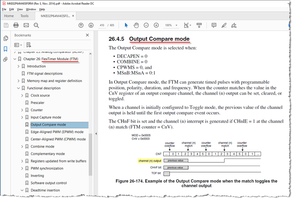

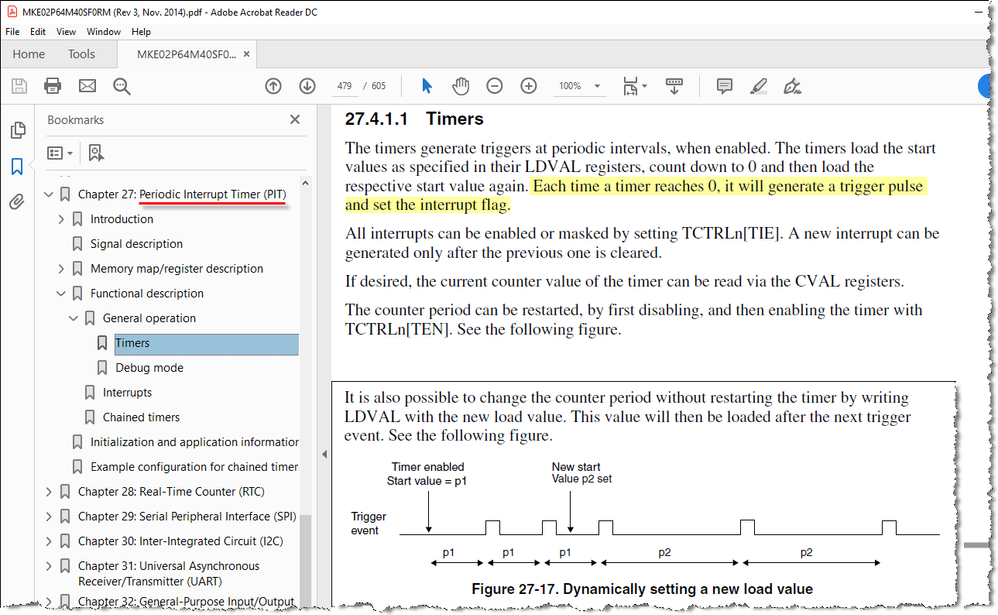

Robin_Shen
Hi Maurizio Spagni,
It seems that you only need the timer set a flag after a specified time, don't need one pin output waveform.
Then I recommend you use PIT instead of use FTM Output Compare mode.
Robin

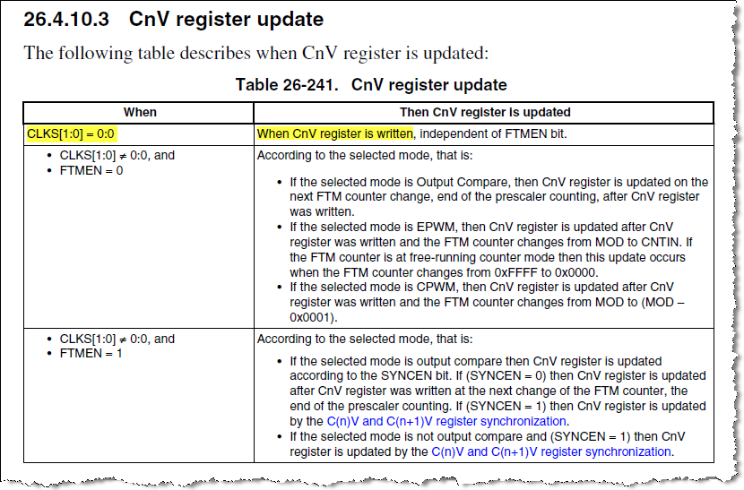

Robin_Shen
Since the thing is absolutely a-periodical, would you please try:
first
FTM2_C0V = 10000;
then
FTM2_SC |= FTM_SC_CLKS(1);
4,098 Views
mauriziospagni
In a nutshell: stop the timer when updating FTM2_C0V.
In my case:
void SetShortTimeout(uint16_t us)
  FTM2_SC = FTM_SC_CLKS(0) | FTM_SC_PS(6); // Stop the timer
  FTM2_C0V = FTM2_CNT + us;                               // New compare value
  FTM2_C0SC &= ~FTM_CnSC_CHF_MASK;          // Reset of the event flag
  FTM2_SC = FTM_SC_CLKS(1) | FTM_SC_PS(6); // Restart the timer
Good workaround... perfect for me and in this case. Thank you very much.
