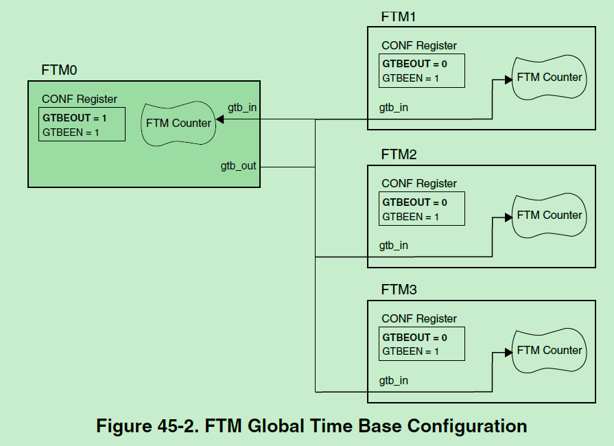

  • There with phase shifting when using two different FTM modules to output PWM signals. Although the two FTM modules using the same clock source (bus clock), there still exists the phase shifting status. Please check attached video about phase shifting.
  • FTM Global Time Base(GTB) introduction
The global time base (GTB) is a FTM function that allows the synchronization of multiple FTM modules on a chip. The following figure shows an example of the GTB feature used to synchronize two FTM modules. In this case, the FTM A and B channels can behave as if just one FTM module was used, that is, a global time base. K65’s FTM0 provides the only source for the FTM global time base. The other FTM modules can share the time base as shown in the following figure:
  • The code description:
   // Configure ftm params with frequency 2MHz for CLK
       ftm_pwm_param_t ftmParamCLK = {
            .mode                   = kFtmEdgeAlignedPWM,   //PWM mode
            .edgeMode               = kFtmLowTrue,           //PWM Low-true pulses (clear Output on match-on)
            .uFrequencyHZ           = 200000u,         //2MHz clock frequency
            .uDutyCyclePercent      = 50,                //Duty cycle 50%
            .uFirstEdgeDelayPercent = 0,
   //using FTM0 & FTM3 GTB feature
   FTM_HAL_SetClockSource (FTM0, kClock_source_FTM_None);   //disable FTM0 clock source
   FTM_HAL_SetClockSource (FTM3, kClock_source_FTM_None);   //disable FTM3 clock source
   FTM_HAL_SetGlobalTimeBaseCmd(FTM0, true);   //enable FTM0 GTBEEN
   FTM_HAL_SetBdmMode(FTM0, kFtmBdmMode_11);   //enable FTM0 BDMMODE
   FTM_HAL_SetGlobalTimeBaseCmd(FTM3, true);   //enable FTM3 GTBEEN
   FTM_HAL_SetBdmMode(FTM3, kFtmBdmMode_11);   //enable FTM3 BDMMODE
   FTM_HAL_SetClockSource (FTM0, kClock_source_FTM_SystemClk);   //disable FTM0 clock source
   FTM_HAL_SetClockSource (FTM3, kClock_source_FTM_SystemClk);   //disable FTM3 clock source
   FTM_HAL_SetCounter(FTM0, 0U);        //clear TFM0 counter value to 0
   FTM_HAL_SetCounter(FTM3, 0U);        //clear FTM3 counter value to 0
   FTM_HAL_SetGlobalTimeBaseOutputCmd(FTM0, true);      //enale FTM0 GTBEOUT
