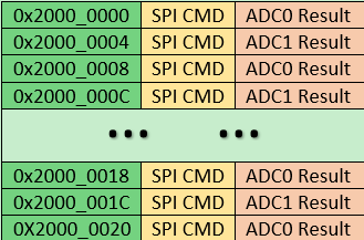

For the customer requires to transfer 9 ADC conversion results out (5 of ADC0 and 4 of ADC1) , the ADC buffer need interleaved storage result from two ADC modules. Below diagram shows the detailed info:

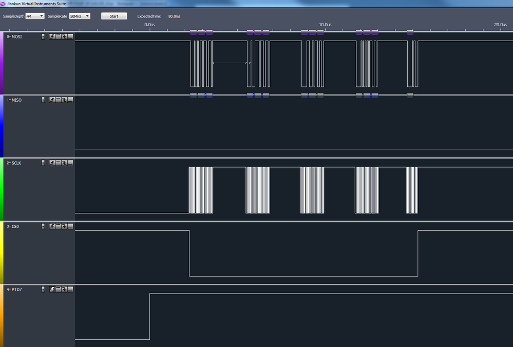

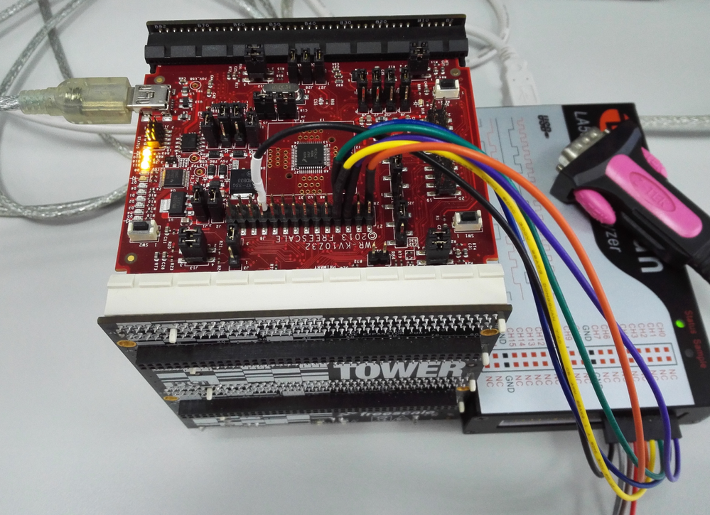

Below is the test result and test environment. It will take almost 15.4us to get and transfer all 9 12-bit ADC conversion results.
