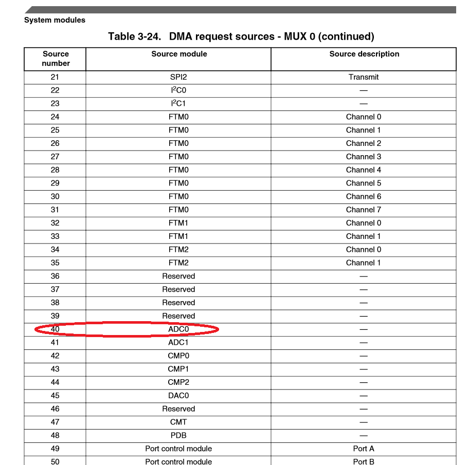

When I read the code about 'DMA channel initlization'.  I met with an issue :
One configuration is " DMAMUX_CHCFG1 = DMAMUX _CHCFG_ENBL|DMAMUX_CHCFG_SOURCE(40) ". Could you tell me what does this "40" mean?
I've checked  the detailed information about  'Channel Configuration Register (DMAMUX_CHCFGn)'  in the K10 Chip manual.
The DMAMUX_CHCFG[SOURCE] represents " DMA Channel Source (slot) ". It's described as " Specifies which DMA source, if any, is routed to a particular DMA channel. Please check your device's Chip Configuration details for further details about the peripherals and their slot numbers."
The " slot numbers" (such as 40) correspond to what DMA source, could you tell me?

Kan_Li
Hi Yanli Cheng,
If you refer to Chapter 3 Chip Configuration in K10P100M100SF2V2RM.pdf, you may find  details regarding DMA source on page 85, and 40 here represents ADC0, please refer to the following for more details.
Hope that helps,
Kan
Freescale Technical Support

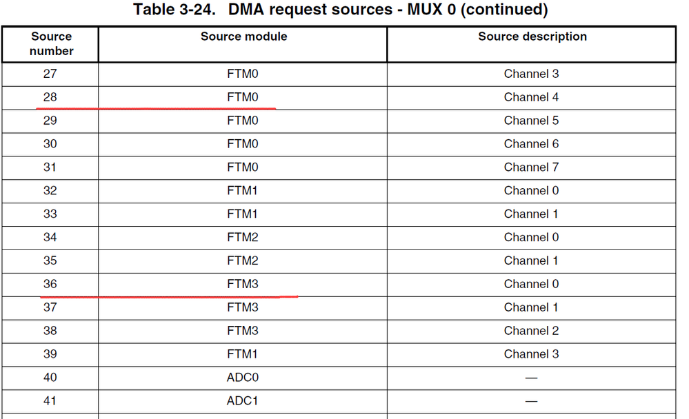

yanlicheng
Thanks a lot for your answer, Kan_Li. I've found this table in the chip manual under your help.
But I'm still confused about the concept of  'DMA request source'.  I've tried to search some useful explanations on the web, but still not found anything clear.
Could you help to explain or give some useful reference?
My confustion can be illustrated by the following 2 examples:
(1) I want to use DMA to transfer ADC data and I refer to the document "Using DMA to Emulate ADC Flexible Scan Mode on Kinetis K Series", which is downloaded  from  FreeScale official website. In the 'DMA channel Initialization' part, the DMA channel 1 request source was configured as "DMAMUX_CHCFG1 = DMAMUX _CHCFG_ENBL|DMAMUX_CHCFG_SOURCE(28);  " , and DMA channel 0 request source was configured as "DMAMUX_CHCFG0 = DMAMUX _CHCFG_ENBL|DMAMUX_CHCFG_SOURCE(36) ; " .  This example  uses the Freescale TRW-K60N512 development board. I checked the K60 chip reference manual and knowed that '28' represents FTM0 and '40' represents FTM3.
(2) When I do research about another project example, which use K10 series chip and also use DMA to transfer ADC data. The DMA channel 1 and channel 0 request source are all configured as '40'. According to the K10 reference manual , this means DMA channel1 and channel 0  request source are all 'ADC0 '.  Other configurations are similar to example one.
In a word, how to configured the DMA request source? Based on what principle?

Kan_Li
Hi Yanli Cheng,
Actually you may understand eDMA module as a co-processor for MCU, the DMA channles are interrupts of this co-processor, and DMA sources are just like interrupt sources, but more flexible , for example, the same DMA sources can be assigned to different DMA channels, but it is not recommended sharing one source for different channels , because RM says "Setting multiple CHCFG registers with the same Source value will result in unpredictable behavior."
and when you assign some source to a DMA channel, this module will have the trigger signal from that source under some condition , for example, if the DMA source is ADC0, the trigger signal comes when ADC0 COCO bit is set, and then DMA module does the  presetting transfer just like a co-process handles the ISR.
so you may assign to any DMA channel with any DMA source, depending on your application.
For more details on DMA source, you may refer to the chapters in RM, each  module which has DMA support usually has a register regarding DMA operation, which can be found under the section of "Register definition". and some module chapter contains a section for DMA operation as well, such as FTM module.

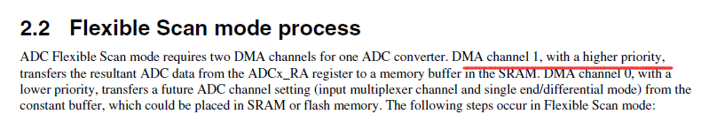

I want to ask you a question. As to freescale K10 chip, is there a default priority setting among the 16 DMA channels?
That means ,does channel (n+x) has a higher priority than channel n ?
Because in the pdf document " Using DMA to Emulate ADC Flexible Scan Mode on Kinetis K Series", it says :
I didn't find corresponding information about default priority in the RM(only finds the register 'DMA_DCHPRIn' can set priority for DMA channel n).
8,339 Views
Kan_Li
Hi Yanli Cheng,
Actually eDMA supports fixed-priority and round-robin channel arbitration, which is controlled by DMA_CR[ERCA], and module uses fixed-priority arbitration out of reset, in which the channel service request from the highest priority channel is selected to execute, and the contents of DMA_DCHPRIn defines the unique priorities associated with each channel . The channel priorities are evaluated by numeric value; for example, 0 is the lowest priority, 1 is the next priority, then 2, 3, etc. Software must program the channel priorities with unique values;otherwise, a configuration error is reported.
and for round-robin arbitration, channels are serviced starting with the highest channel number and rotating through to the lowest channel number without regard to the channel priority levels.

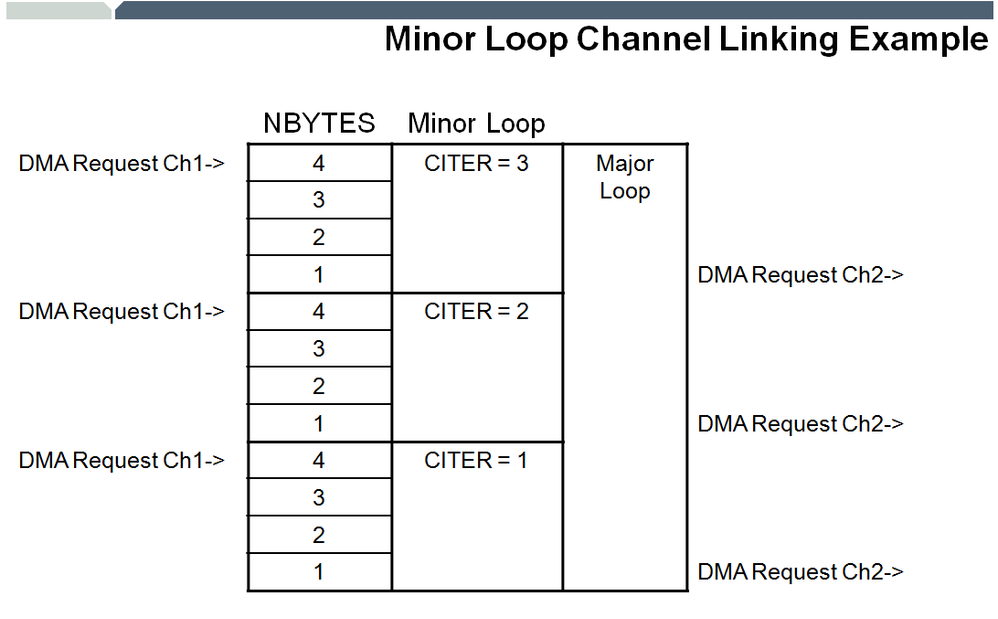

Kan_Li
Hi Yanli Cheng,
Per your application, I would recommend you using one channel for two DMA transfer you mentioned above:
(2)DMA channel 0 was used to choose the next ADC channel number. Major loop transfers number 12.
(3)DMA channel 3 was used to choose 'MUXSEL_ADCA' or 'MUXSEL_ADCB' for the next channel. Major loop transfers number  12.
you may find the above two have the same Major loop transfers. so you may do them both in a single channel. for example, channel 0.
so channel 1 used to move the ADC results, channel 0 used to configure the registers of ADCx_SC1A and ADCx_CFG2.
Please enable Minor Loop Channel Linking mode for that case. ADC0 COCO triggers Channel 1 transfer, and each minor loop completion event trigger channel 0 transfer. Please refer to the following for more details.

yanlicheng
Thanks so much, Kan_Li. Your answer helps me a lot.
(1) I rechecked my code according to your answer, and found one mistake: although I enable 'Minor Loop Channel Linking', I didn't set the linking channel number ( I only set it in 'Major Loop Channel Linking').  In old project, because DMA channel 1 links to channel 0, it doesn't matter whether DMA_BITER_ELINKYES_LINKCH(x)  is set. But in my new project when DMA channel 0 links to channel 3, I must set this value.
(2) I still use 3 DMA channels, and it can work. Now the 'MUXSEL_ADCA' or 'MUXSEL_ADCB' selection works right.
In your answer, you recommend that I use DMA 0 to to configure the registers of ADCx_SC1A and ADCx_CFG2. I don't understand how to realize it. The destination address can only be set to the address of one register, right?  How to simultaneously use both ADCx_SC1A and ADCx_CFG2 as the destination address?

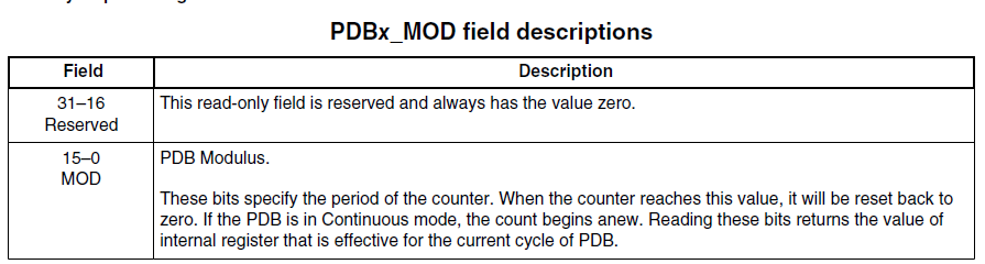

In the RM for K10 series chip, the 'PDBx_MOD' register was described as follows:
When I study one project, the setting for PDB is: PDB0_MOD = 50000000/(samplerate*4);
Here, samplerate=2000, and thus PDB0_MOD =6250.
I've two questions.
(1) In my view, 50000000 is the frequency of bus clock. and also the counter frequency of PDB. Is that right?
(2) When I changed 'PDB0_MOD'  to a smaller value, such as 5000. The program will reset. What causes this to happen?
