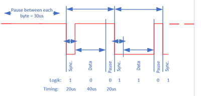

Currently I am using FTM timers to generate few bytes of data by toggling a pin.
But this consumes lot of CPU cycles. The signal which is generated using the FTM timer has a logic 1 for a signal which is atleast 40us held high.
I want to replace FTM using the DMA, for this I built a simple example where I try to set a port pin to high.
I am using MKV10Z64VLF7 microcontroller. The port pin I want to toggle is PTB 17.

Mitun92
Yes, I would like to use DMA to write into the GPIO->PDOR register to toggle the pin.
My application is to send few data bytes at a fixed interval of every 50ms. The 50ms timeslot is controlled by my Time Slot Monitoring State machine. But to generate the data I used a FTM timer, whích created a event everytime the counter had a overflow, with this I could Hold or Free a Port signal to generate data. The problem of using this method of using FTM timer was that the FTM interruput for the overflow event, interferes with my CPU run time. Thats why I am looking for alternatives.
I am attaching a illustration on how my data bytes would look like :
