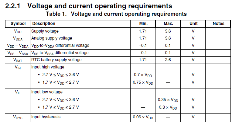

Robin_Shen
What's the voltage of VDD? Why the voltage of PORTC18 is 2.1v when not pushed. If there is no external pull up resistor, then please enable the internal pull up resistor for PORTC18. (PORTx_PCRn[PE][PS]) You can refer the SDK example.(...\SDK_2_11_0_FRDM-K64F\boards\frdmk64f\driver_examples\gpio\input_interrupt)
Notice: If the pin is configured for a level sensitive interrupt and the pin remains asserted, then the flag is set again immediately after it is cleared.
Please measure the voltage of PORTC18 by using oscilloscope, check the value meet the VIH VIL.
2.2.1 Voltage and current operating requirements.png2.2.1 Voltage and current operating requirements.png
